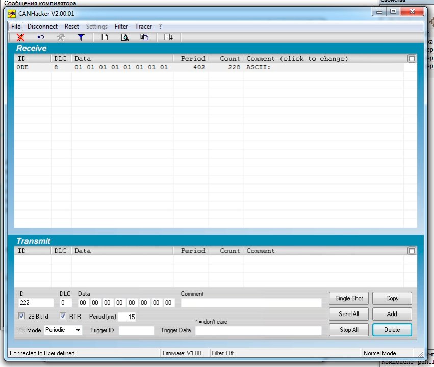

I made some new experiments and catch regularity. If I make simple program with cycle for 3000 and macro:
CAN2 Set TX ID simple
CAN2 Set TX data
CAN2 sendBuffer
It didn't send half of the all frames.
It sends all of them if I put delay to cycle more then 1200us and it is veeeery bad for my program, but decreases mistakes to 0,075%
This delay can be less more then 2 times if I use only one macros (SendBuffer).
If I choose software mode for CAN2 - it works slowly but the same way.
And CAN1 send everything without any delays. It works perfect!
So I think the main problem in external CAN component. Maybe it doesn't have some checks if the registers ready. And of course maybe I am again on a wrong way)))

Some new experiments
The first image for internal CAN1 Next for external CAN2 - used 3 TX buffers 1->2->0->1...
Barmaley_GMN
- Posts: 59
- Joined: Mon Aug 04, 2014 12:59 pm
- Has thanked: 8 times
- Been thanked: 4 times
Re: SPEED CAN-BUS inernal external
Next with one TX buffer (1-1-1)
Next one like previous but added faster SPI (x4)
If I add 2us delays after every CAN macros - it doesn't matter the result on the screen is the same.
I made some tests for every variant I have seen different periods but the same Count of received frames.
