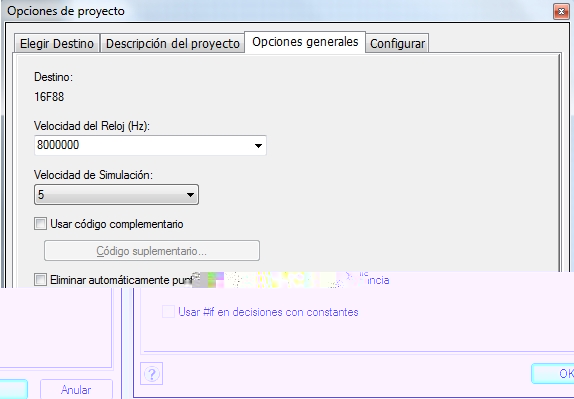

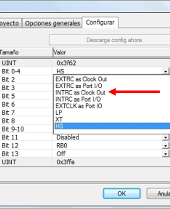

Hi Friends, I need to use internal oscillator in pic 16f88, But I have never used internal oscillator in flowcode, And I have doubts of his configuration...

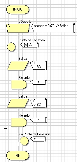

I have realized this program with this configuration and it me does not work...
Might you say to me in that I have been please? :?

Hi, The problem this one solved, Since I have seen that my program was not working,I did the one that I put in the forum, which is very basic, Since this one does not work either,
I have bought 10 new 16f88 .....And I have discovered that this is the failure, them 16f88 that it was using bought previously, they came badly from factory, :shock: With the new ones 16f88 already there is no problem ..... regards
