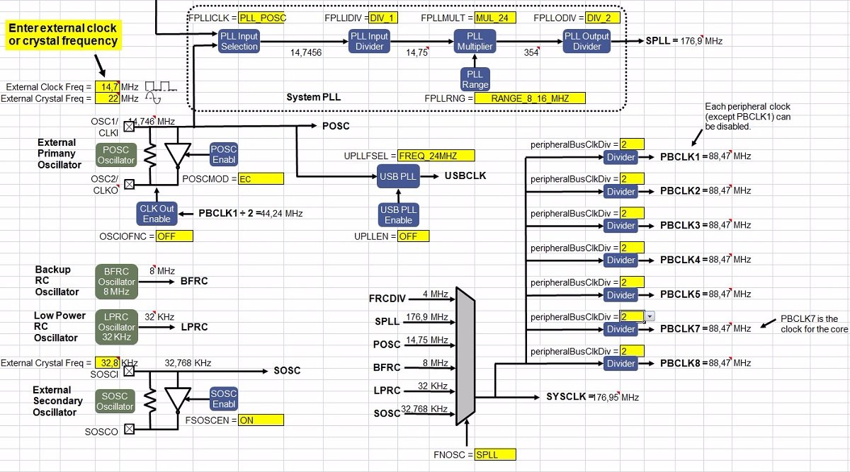

If I set the UART to "Channel 6" in the attached program, it can not receive the characters. If I set channel of UART to "Software", it works perfectly. The external clock of the MCU is 14.7456 MHz.
I also attached the clock settings.
( I tested the UART transmitting direction also with these settings, it worked in both cases.)
