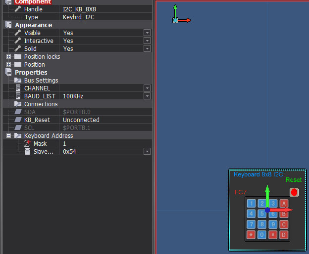

I am working on a prototype device which, will scan a keyboard ( will be up to a full 80 plus keys) and send the key pressed to your project, using the I2C protocol. This device is independent to your project, therefore, it requires a FC7 component to communicate with it.
Everything is working well so far, but I need to be able to get the graphic the way I want it for the FC7 component. This is what it looks like so far:
Q. How do I get a suitable graphic of a keyboard to display correctly within FC7. When I put a jpeg file attachment to the component is only shows a white square. :roll:

Hi Dave,
Sounds good :D
You could try adding the image as a resource, via the export component properties menu,
Then add a rectangle object and add the resource to the image property of the rectangle

Hi LeighM
Thanks you for suggestion. This is what is displayed within the component build:
(56.25 KiB) Downloaded 3146 times
This is what is displayed when the component is placed in a project:
(9 KiB) Downloaded 3146 times
There is a small red exclamation mark next to the image file, not sure what it means.

Hi Dave
Well it looks like you have identified a recently introduced bug in the component resource feature, which is inhibiting their selection as an image to a drawing primitive.
The exported component will need the resource feature to work for images to be visible to component users. So it’s something that we have raised here as needing fixing in the Flowcode executable.
As a temporary workaround, using the absolute path, rather than relative, to the image for the image property should enable the image to be seen in the exported component. But only on your PC that has access to the image. Hopefully that will allow you to continue working on the component.
Regards,
Leigh

Hi Leigh
Very much appreciate your help. However, putting the full extension details in has not solved the problem.
No matter, it will not prevent me from continuing to developing this component until such time the issue can be resolved.
Dave

Hi Dave,
I've found a workaround using the Component -> Initialise event.
You add the image to the resource manager as usual.
Then enable the Initialise event and assign a macro.
Inside the event macro use the File.AbsPath function to get a path to the file as a string.
You can then assign this to the "Image" property of the component.
This seems to work well but obviously is not as cool as being able to load the image directly.
Here is a demo you can follow.
v7.fcfx
(8.24 KiB) Downloaded 391 times
Let us know how you get on.

Hi Ben & Leigh
You guys are brilliant. Solved. :D
