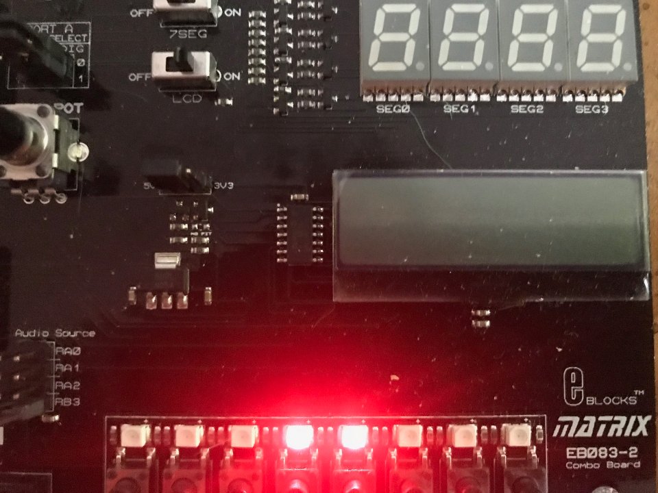

- IMG_3246.jpg (149.18 KiB) Viewed 15753 times
What LCD is this???

The LCD is interfaced with a device that emulates the generic alphanumeric display of the previous version.
You are best using the Combo Board (EB083) Flowcode component to drive this board.
Re: What LCD is this???
Let us know if you have any problems with it. It's one of my EB2 creations. As Leigh says it should work fine with the EB083 component.
More information can be found on the LCD Embedded Font Set page of the EB2 datasheet(Currently page 43).
https://www.flowcode.co.uk/old_site/resources/get ... hp?id=1075

Hi Benj
I have a problem with this combo board BL114 and using the older combo board still has problem of printing twice on display although this does not happen when using EB005 16x2 component with the compo board.
