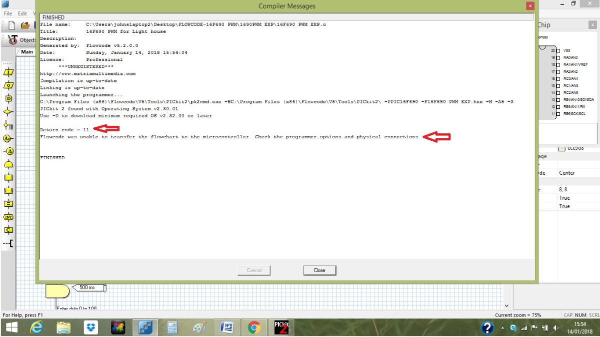

Hi, what does this error code mean and how do I fix it? All was working well and then suddenly this ERROR 11 appeared when I tried to transfer the program to the chip.

Hi John,
Error code 11 is:
OS firmware must be upgraded
You could see if this works?
