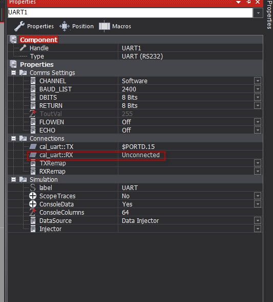

Looking at your Flowchart briefly ,It seams your Receive pin is not connected -The UART Component need to have its RX pin connected as in the case of the TX pin

When I open my Flowcode v7 the connections are normal.
TX connected to pin. 2 and RX connected to the pin.
"Errors" happen in the same way as I have described above.
I think rx had not called him, he would not get a reply.I'm attaching the file again for you to see.

Peter is correct with what he is saying on all counts.
You have got RX connection on your flowchart unconnected!
Also, for you to reliably received from vnc1l, you should used RS232 hardware not software.
Also use RS232 interrupt (UART RXINT x) otherwise you will miss the data being received.

I changed the MCU by one by one 33fj256gp710 that when I open the properties panel there are 2 channels uart hardware, and I used one of the channels.
It worked. I showed in the display 62 decimal> ascii and 13 decimal CR ascii.
But I have to use the MCU 33ep512mu810. When I open the properties panel of this MCU does not appear any hardware uart channel only the software option. What are the pins of this MCU that are hardware uart channels since it does not appear in the properties panel.

Hi Ricardo,
there must be something wrong with your FlowCode installation or something as when I select the MU810 I have Software and 4 UART Channels plus remap able see attched
