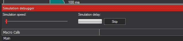

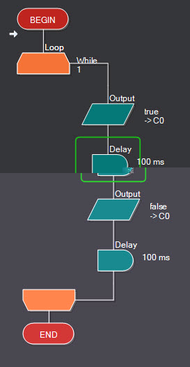

Now when I use my Flowkit 2 on a simple Led blink program(only 1 Led ) then the
(1) green square follows through the Flowchart at a Rate of 1 too 2 Hz as if I had slowed the Simulation speed down
(2) The Simulation speed is set at normal.

Attached the flowchart and the simulation speed setting.
