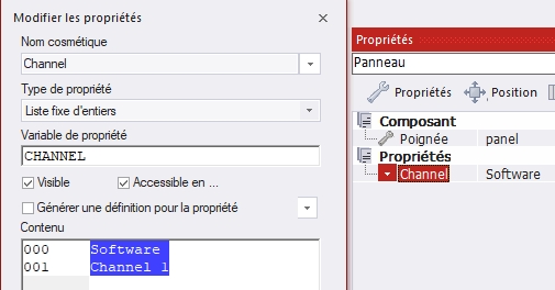

Hello Bruno,
I just noticed that (in FC7) if you right click on Properties->Channel->Edit->Property Type->Fixed List of hints and select Bit Mask->Cancel, it will show correctly Software/Channel1!

Re: Popup missing component creation
Thank you Giuseppe!
I already spotted this problem with other components such as injector "Flowcode Vnet" or others that do not want to take into account (popup empty) a modification of programming or hardware. So I tested with a change of ownership but I had not tested with "Bit mask"!
Before modify "Bit mark" After modify "Bit mark" For example for the UART, just switch the UART channel selector (and switch again) for popups to activate for "Data Source" and "COM Port"; changing a property updates the popup windows!
