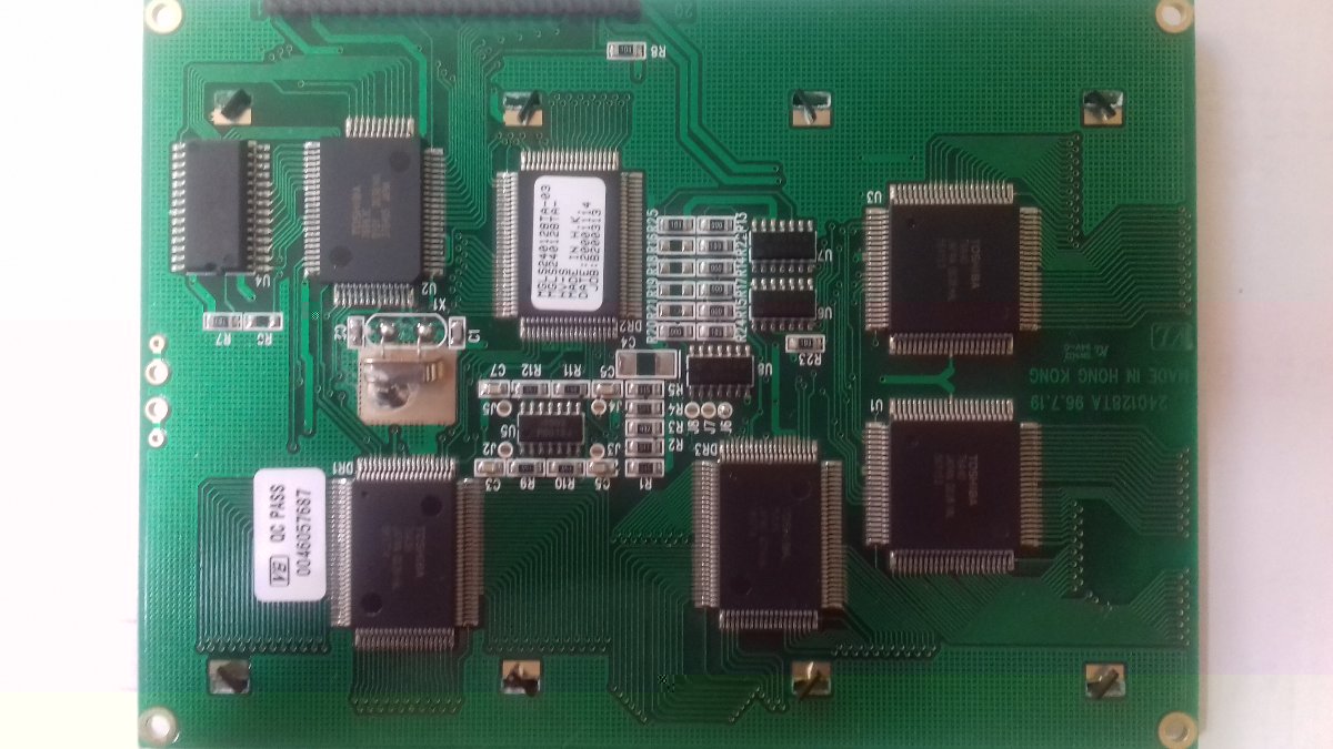

Ηello to all!
I would like to use an GLCD to display some messages . So I tried to send some characters to GLCD to test the component. As GLCD I use a VARITRONIX MGLS240128TA-03 . The GLCD is new but not work. I was checked the connections with PIC but I don't find something wrong. The test code works with simulation mode, the PIC works ( I was checked with oscilloscope), so what is the reason for that? The component maybe? I post below the test code and an icon of GLCD , for any help. Thanks in advance.
- GLCD-VARITRONIX-MGLS240128TA-03.jpg (154.16 KiB) Viewed 26471 times

There are many different GLCD controller available. Flowcode GLCD components only support a few of them. I don't think your display uses a supported controller.

Thanks Kersing for info. As I saw in GLCD pcb , the controller is T6963C , that is supported by FC7 components. Below is data sheet of GLCD that shows the controller. Is that supported from FC7 components?

If you read the entire post from beginning you'll see front/back of my gLCD.
Giuseppe
I can exclude that because it's supplied with 2 18650 Li-Ion battery with a regulator to 5V. Vcc is always stable at 5V (checked by oscope).celebriums wrote:Could the power supply or LDO not supply enough current?
I already tried to put delays after each gLCD call but no change.celebriums wrote:Software should also add delay after gLCDintial operation (ex: 100ms)
See my data above. I got data from PortC so I can't see anything wrong in the Port. Also I measure 2 MHz at RA6 which is fosc/4 as expected because I set the internal osc at 8MHz.celebriums wrote:You should check PortC1 connection and internal oscillator settings.
This is a good point. The controller for sure is a T6963 by Toshiba (it's the most upper right chip in my picture above) however I couldn't find a specific schematic. It could be some smd resistor to set but I don't have useful info. Of course if you have a similar (old!) schematic I would be thankful!celebriums wrote:and What is LCD brand? (is not T6963,hantronix or toshiba ) ex: Winstar, Raystar etc
Usually (jumper) is on LCD nin as Dummy Resistor.
Giuseppe

Re: GLCD NOT WORK
Thanks for information.
I think the difference between your t6963C and the communication speed of the microcontroller.
I watched the video, I saw you work on a breadboard instead of a PCB.
In addition, can you test the functions in the following software? If not, will you try using an external oscillator?
Note:
Changed the codes.
Please pay attention to the transparent option in the codes.
please pay attention to the LED flashing speed and forget the external oscillator option.
Note:
Changed the codes.
