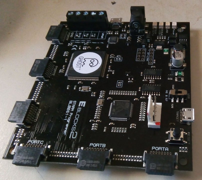

Hello
I received the new E-blocks2 ST-ARM programming board BL0061 but cannot find its USB driver.
The mLoader (v 4.0.0.1) does not recognize the BL0061 as well.
Could you help me, please?
Best Regards FOTIS ANAGNOSTOU

I purchased the bundle BL0596 which except the BL0061, also includes the E-blocks2 BL0114 Combo board with multiple LEDs, Switches, LCD etc.
I did manually the installation of BL0061 USB drivers, using the device manager of windows with success.
However, I don't know if the installed driver is the 64bit or the 32bit. I hope it is the amd64, as the OS of my PC is Win7 x64.
In Devices Manager, the installed driver is referred to:
Custom USB Devices
BL0061 Ghost2 STM32 Programmer
Supplier Matrix Technology Solutions Ltd
Date 6/1/2015
Version 1.0.0.5
The mLoader recognizes the BL0061 board, but when I try the autodetection of installed CHIP it reports "Chip = BL0061(6241).
In FC7 (v 7.3.0.5 / License version Proffesional / PIC / ARM) the board is listed on "Project Options / Choose a Target" in both: "Target / ARM / Misc", OR "Target / Free".
You could select BL0061 from either ARM or Free.
In FC7 main window, the built on micro STM32F401RC appears correctly.

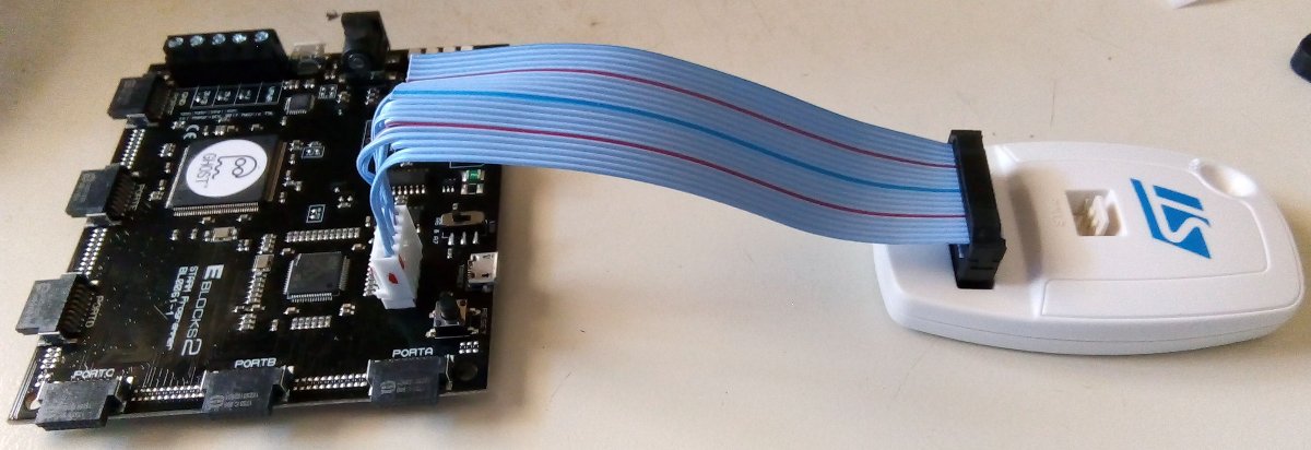

The preinstalled STM32F401RC micro on BL0061, can also be programmed using the ST-LINK/V2 and the ST Visual Programmer application.
You have to solder a 5-pin header on BL0061 and to assemble a 20p flat ribbon cable, terminated at a 20p IDC socket on one end (ST-LINK side) and a 5-pin housing on the other end.
The interconnections are shown in this picture (Updated. I forgot to include the RST connection in yesterday post)
(9.41 KiB) Downloaded 4711 times
You could still use the Flow Code to build projects and to compile in hex format. Later, with the ST Visual Programmer, you can open the hex file and flash the code in the STM32F401 with the ST-LINK. It is tested and working.
Pictures attached:
