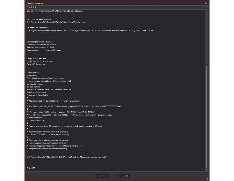

Compiles for me. Can you post your msg.txt file?

That's it

Hi seokgi,
The message is saying that flowchart has compiled OK but has an issue with programming target device.
So the hex file is being generated, just not transferred to chip.
My advice would be to use IPE.
If you have not got it then download MPLAB X installer then during install you can select to install only IPE if required.
IPE is the PICkit 3 programming software. If you want PICkit 3 to power target device, then you can enable that from the advance menu.
Also I have noticed that you have watchdog timer enabled.
Try disabling it and then see if all works.
As MCLR is enabled, is pin 4 pulled to supply voltage ?

I did not find any problems in the above program so I found a problem with the circuit part. The output of the NE555 was connected to the PGD, causing an oscillation. I removed that part and the download issue was resolved. And the PIC12F1840's memory is small and the program is a problem. The RTC component consumes too much memory. Give me a solution.
