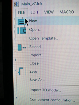

The visual bug is reproducible:
I couldn't get a screen shot - so I've attached a photo of a an example:
It doesn't seem to be connected with opening a particular file - and sometimes only occurs after opening a couple of times. It doesn't seem to get worse with multiple openings - once the shift has occurred and it doesn't revert to correct (restart does) nor does it affect the menu actions....
DanielM
Posts: 62
Joined: Mon Oct 23, 2017 9:54 am
Has thanked: 11 times
Been thanked: 22 times
Re: Grouping 'problem'
Post by DanielM »
Martin,
Thanks for the screenshot. It's helped me to understand what you meant a bit better.
But I'm still struggling to reproduce it! I've made a note and I'll keep investigating and hope to get it resolved by the next minor release.
