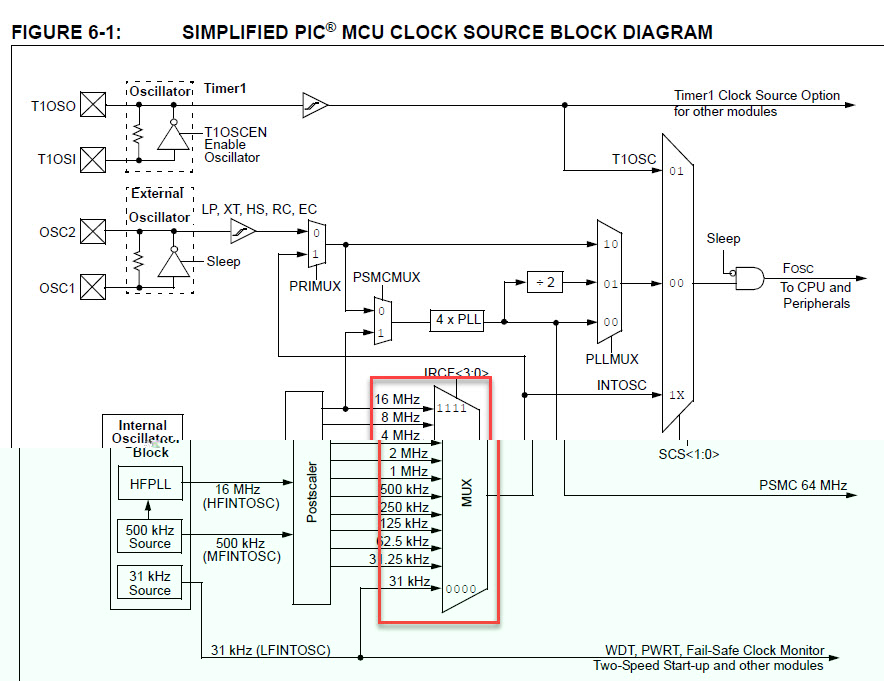

Looking at the datasheet the device does not have an 32Mhz Internal Oscillator only a a 31Khz ?
maybe I misunderstood your problem
The device can be clocked with a maximum of 32MHZ with an external clock source (including the 4xPLL) it does not have a 32MHZ OSC internal the options are as shown in the marked block

QMESAR wrote: The device can be clocked with a maximum of 32MHZ with an external clock source (including the 4xPLL) it does not have a 32MHZ OSC internal the options are as shown in the marked block
Sorry I don't agree with that.
You can set the internal osc at any of the speeds shown on the datasheet for given OSCCON value.
An external clock is not required.

medelec35 wrote:You can set the internal osc at any of the speeds shown on the datasheet for given OSCCON value.
Martin you are correct looking more closely at the OSC it true what you said ,I missed the path from the Internal OSC MUX to the PLL
