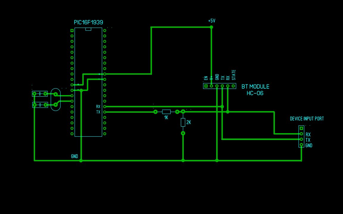

Re: BLUETOOTH MODULE NOT WORK
Dear medelec35,
many thanks for your help...I send you circuit diagram....about HC-06 red led flashes quickly 3-4 times/sec...it seems that there is no change from AT command to DATA mode, because there is no communication between mcu and BT module...about Android the problem is that the program runs only in windows...if its possible to run that in android it will be easy to send info from mobile phone...thanks.
- HC-06 + PIC16F1939.JPG (46.4 KiB) Viewed 29876 times
- Posts: 9521
- Has thanked: 2585 times
- Been thanked: 3815 times
You're welcome.SILVESTROS9 wrote:Dear medelec35,
No that's not the case at all.SILVESTROS9 wrote:C-06 red led flashes quickly 3-4 times/sec...it seems that there is no change from AT command to DATA mode, because there is no communication between mcu and BT module
I Did state
That's not strictly true.medelec35 wrote:With the HC06's I have they are automatically in AT command mode when not paired.
It needs to be paired and Software with windows device e.g. Tera Term has to be connected to BT before it will go into data mode.
Hardware looks correct but what are you connecting to Device Input Port?
So long as you have software that connects to bluetooth and sends ASCII data, does not matter if Andriod or Windows.SILVESTROS9 wrote:about Android the problem is that the program runs only in windows.
Either will work as I have used both.

- Posts: 9521
Hi SILVESTROS9,
Had a bit of time spare so took another look at your diagram.
It will not work with 2 devices connected to one UART channel.
For this to work, you need to choose a device with 2 separate UART channels.
Bluetooth on one channel and RTC on the other.
If you must for some reason keep 16F1939 then Bluetooth on software and RTC on the channel.
To find a suitable device you can look at the devices Steve001 compiled.
Or you can look at parts within Matrix's own database.

many thanks for your help...about HC-06 working, I send you the updated flowchart for PIC16F1939...The flasher test is ok, but nothing works for HC-06.....no change name , no change pairing code....I have no problem to change the mcu , just I used that to make a working test for HC-06....If BT module works, i'll use for harware a PIC18F24J50 that has 2 uart...is it possible to work the BT module with that cpu, or it's better to change with PIC18F24J50, make new connections and update the flowchart? what is your opinion? thanks.

I'm a bit puzzled.
You have nothing connected to MCLR in your diagram, yet you state flasher is working OK.
You have 6 connections for BT and wired up 4.
how many pins is soldered on to your BT and is there a reset switch?

One the Flowchart you have got: Which means If MCLR is not pulled high then microcontroller will be permanently in the reset state.SILVESTROS9 wrote: think that there is no need to use a resistor to pool HIGH MCLR pin of PIC16F1939
So how comes the LED on your hardware was on for a seconds then off for a second?
If you have not cot MCLR pin connected, then you MUST selected Disabled for MCLR Pin Function
I asked about the pins since you had six on your circuit, so that would Be a HC05 which will rewire either switch pressing, or better still EN line pulled high, I would use a port to do that.
But as BT only has 4 pins, that's not required.
Just to double check, I downloaded flowchart you just posted, only changed Name and pair code to something different within the call macros, and change the name and pair code changed successfully.
New changed name of HC06 appeared when I selected forget connection and re-paired BT on my phone.
So its defiantly your set-up!

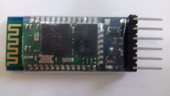

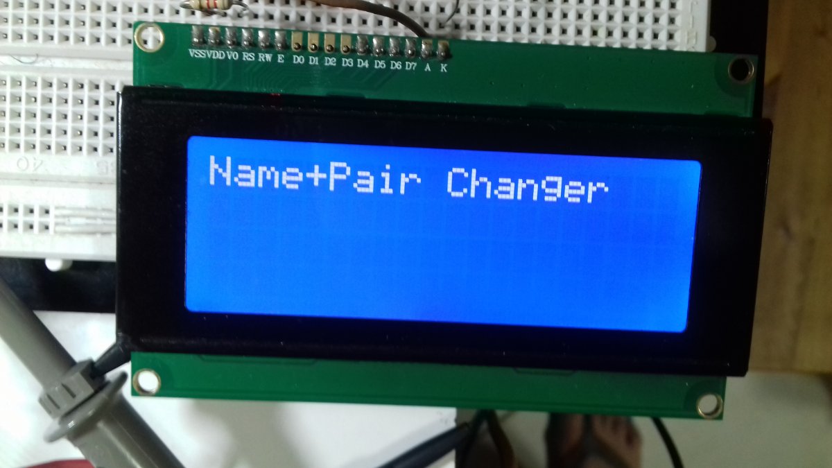

many thanks for help....about BT , I set Disabled MCLR Pin Function Select..I was checked wiring again...BT module has 6 pins (photo)...I was connected 4 pins and pin EN as LOW/HIGH to switching data/at command mode...pin STATE I don't know what it is....I made a new test, no results...it's very strange why don't work at my hardware....I have not USB to UART converter....As the code works at your hardware , I think that maybe there is a problem with programmer, or bad connection , because I use a breadboard to make tests...I'll check that...thanks.

State is just an output that is high when there is an established connection.
Do you have an LCD you can use that for diagnostics?
Your hardware is different to mine.
I have both HC05/06 from a few different suppliers.
All HC05 are 6pin with an enable switch + enable state pins that must have enable pin high and 38400 baud for AT commands to be accepted if not being accessed
All HC06 have 4 pins an in AT mode if not being accessed.
Perhaps you could get hold of the standard 4 pin HC06?

I would like to thank you for your efforts...yes I have an oscilloscope (Rigol DS-1054), also LCD 4x20...I made some changes to lcd component and I connect LCD ...i get the info as below...about BT module, it seems that my module is HC-05....I have no module with 4 pin...Ι get some measurements at RX, TX pins with Rigol but no data..is there a way to test that ? thanks.

The difference between HC05 (EN connected to +5V) and HC06 when power is first established.
HC05 LED will go on and off every 2 seconds, that's what mode you need to be in.
If that is the case then I can send you an updated flowchart to change parameters.
HC06 LED will go on and off about 4 times a second.
So there is a big difference.
However with HC05, if nothing is connected to EN then LED will go on and off about 4 times a second.
That's the same as HC06 but commands will not work as it's not in AT mode.
After all the above, can you determine which module you have

It's easy to test communications side.
Make sure you have only the bluetooth connections to RX and TX of microcontroller.
Pair mobile or PC to BT. Send repeated U (must be uppercase)
Develop flowchart so you either have an LCD or UART to USB lead so you can see received characters.
If neither then use an LED then if received a string = "U" or char = 85 the pin connected to LED goes high.
THe reason for U is if RX is displayed on the scope then you will see alternate 1's and 0's
Since all the same width then Baud = 1/time.
Sounds like you have an issue with hardware.
