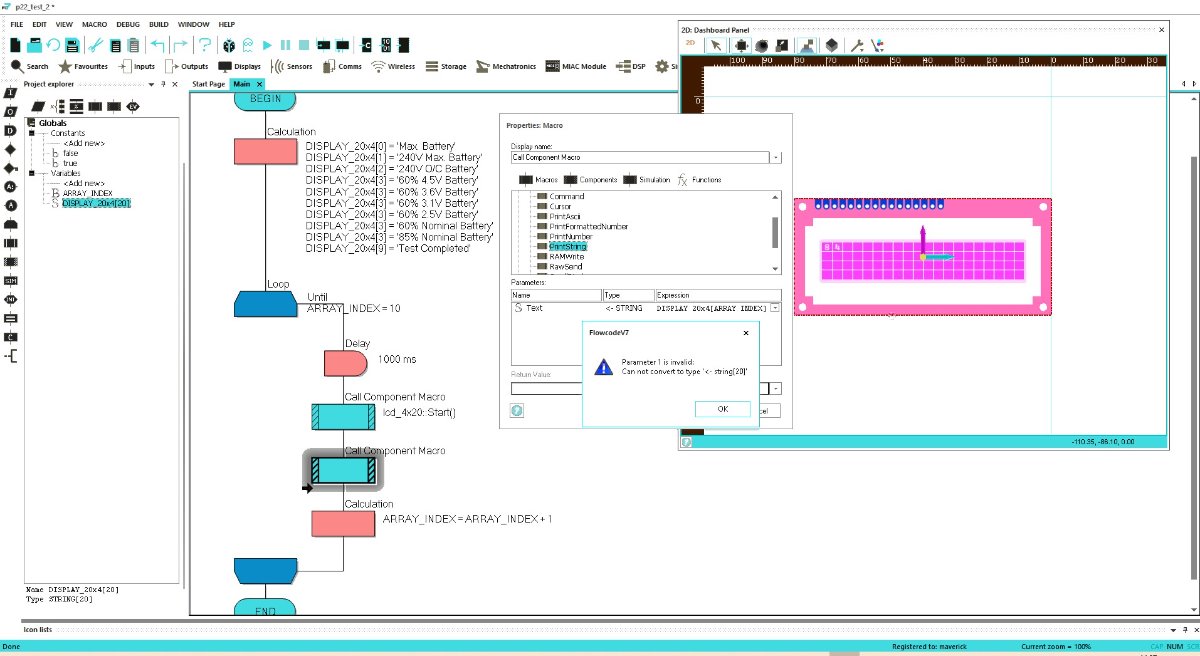

I'm trying to display text from an array using a 0 to 9 counter and display text on an LCD screen
I have created variables byte ARRAY_INDEX INITIAL VALUE 0, AND string array DISPLAY_20X4[20]
I then added text to the array using a calculation box.
using component macro LCD_4x20 print string "hello world" works fine
using LCD_4x20 print number ARRAY_INDEX works fine
however when I try LCD_4x20 print string DISPLAY_20x4[ARRAY_INDEX], then an error occurs parameter1 is invalid: Can not convert to type ‘<- string[20]’ as shown in .jpg attachment.
please advise what I'm doing wrong and/or suggest a solution, flowcode file also attached

Hi Gavin,
Welcome to Matrix forums.
When you want a string array, when creating the variable, you need to place the number of elements within the Array Length box.
Then click on Add Array Dimension.
All array Strings will require double not single quotes.

Re: problem displaying text from string array to lcd screen
Hi Martin
thanks for the prompt reply. I have opened test 3 code in flowcode 7.
When I run the modified code test completed appears on 1st loop, then nothing on the screen for the other 9 loops.
i have added print number array_index to the lcd screen and when run this increments from 0 to9
Gavin
Gavin
