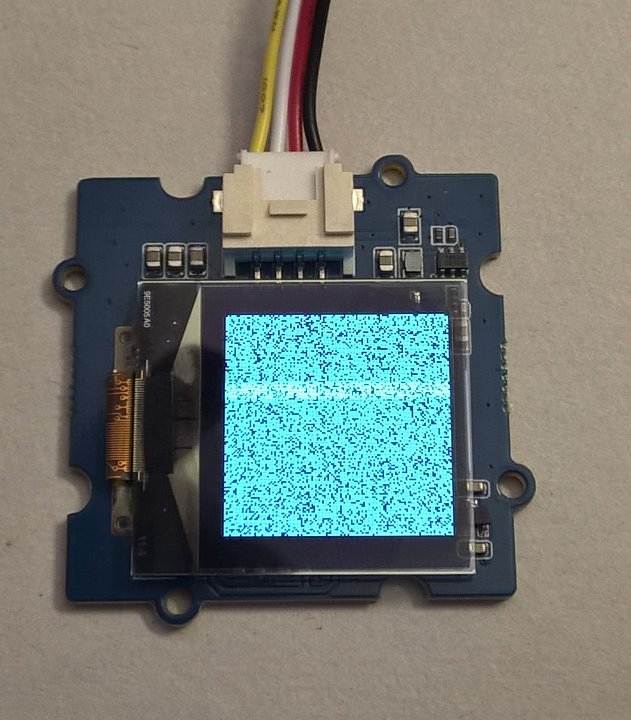

I have tested both 1.12 "display with both controllers, but they only show the white snow.

The display dont like to work.... The same snow...

I ask because the display is unfortunately black as the night.The I2C signals are present.....

But I am not sure that there is the right grove Oled version. The displays are only black
