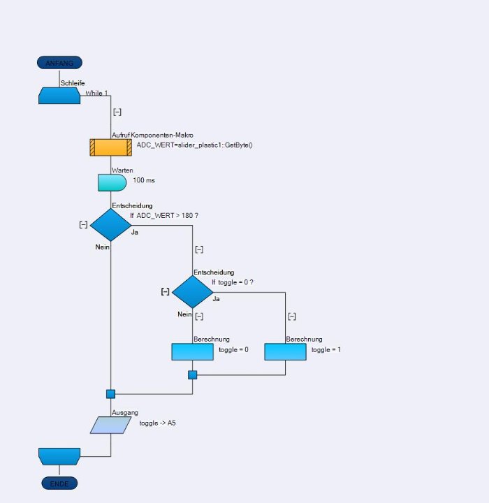

i got some strange Problems by using the ADC wit the PIC16F18313.
I write these very simple Program and connect the ADC Chanel3 to vdd.
I think the value of ADC_WERT should be 255 and the Port A5 should toggle every 100ms.
But the Por will not toggle and when I Debug the Program using MPLABX an PICKIT3 the value of ADC_WERT is 128.
Has anyone an idea?

It might be worth playing with the slider_plastic1 component properties, specifically the conversion speed setting. You are running at 32MHz with a conversion speed of /2 so this is likely far to fast. Maybe try /16 or /32 instead.
As an unrelated side note your delays will be a bit off because you have entered 30MHz as your Project Options -> Clock speed instead of 32000000.

First Thanks for the very very fast replay.
I Try also measure withe FOSC/64 or FOSC/32 but in this case the value ia alway 0
Whe I use FOSC/2 the value is always 128 wit and without vdd on pin3 (AN3).

Ok thanks. I'll take a look at the ADC code for the device and make sure this is correct.
Re: Problems with ADC read out PIC16F18313
I think I've found the problem for you. I've modified the CAL code but can't push it to the update system at the moment as I'm away from my desk.
So for now you can do a manual update if you like or you can wait for the update push, probably tomorrow morning.
Attachments removed!
Reload your Flowcode project and change ADC channel from 3 to 4. Fingers crossed everything should now work as expected.

This fix is now all available via the v8 update system.
