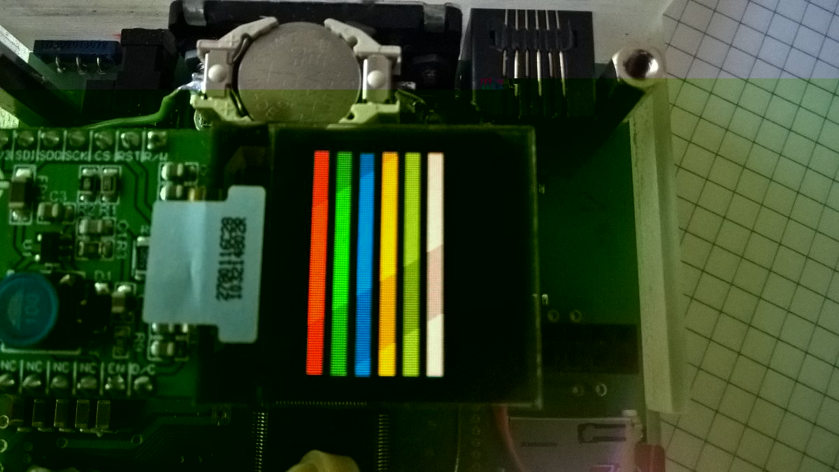

I will use the display. It is very fast and you can comfortably program the graphics with FC8. I have already written a part to make a bargraph. This is because the bars look mirrored good ....
As if you could still turn the characters then that would be great.
The weird pixels are gone since I defined the 96x96 pixel display as 128x128 pixels. Even the colors red and green are only interchangeable.

Very well. The font is now readable
The colors are still changed. Green is fine, but red and blue are exchanged. There is a command to swap RGB in BGR. Maybe you can integrate that too? My bars from the bargraph, now come from top to bottom. I can change that in my software.
A little bit of trouble is still the Graphcreator. In the simulation it's, compile to C is ok, but if I compile to hex, It' gives a lot of errors.
And one more question about the SPI. The interface is now running at 2.2Mhz clock. But that could make the Hardware SPI much faster from the PIC32MZ. Is that a big problem to use the SPI hardware or make the current SPI faster?

Super. Thank you. The colors are correct now and the bars and text too. With the SPI port from the Display is a very small problem. It can not remap MOSI. But with the SPI Master, remaping works with channel 1 on D3
