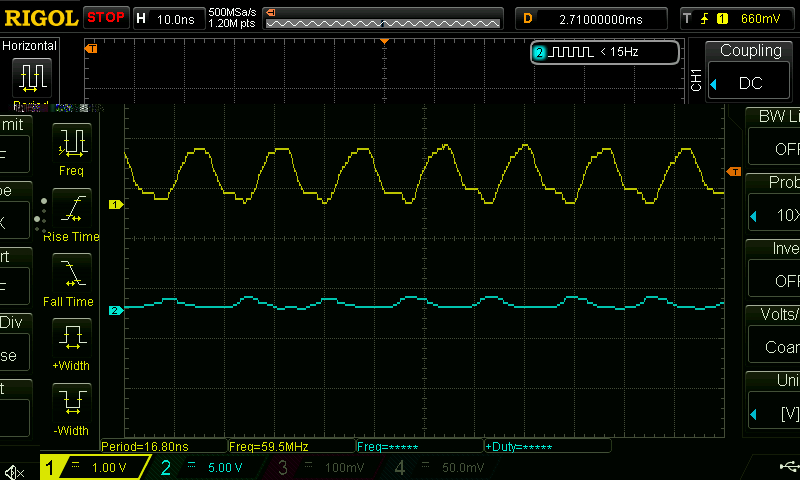

This is a scope capture of the uart RX input pin. The yellow trace is superimposed on the dmx going into the chip.
I am at 10ns per div and it is sending OUT 59.5mhz. My random stab guess is some timer is being set incorrectly initializing the uart?
Chad

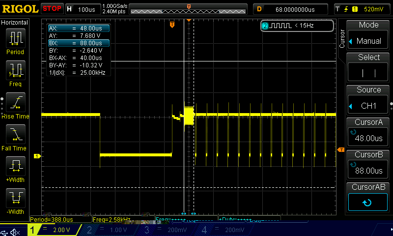

Ok, last pic.
See the block in the center. I think that should be the start code. The square is the ~60mhz output from the rx input.
The rest of the dmx packet looks like it should coming from my dmx transmitter. Maybe It will help you debug it.. Something is sending a goesouta when it should just be a goesinta.

Right I've been testing this using a 8-bit PIC and I've replicated the initial problem you were having. The 60MHz I am guessing is simply noise due to the floating input.
I have now overhauled the components so that instead of uninitialising the UART and using delay based timings I now use the UART hardware itself.
The Master switches Baud rate to 57600 to achieve the break and MAB timings and then switches back to 250000. A new CAL baud has been added to the various CAL UART files to allow for jumping back to the 250000 baud.
The Slave sticks on 250000 baud and looks for a framing error to detect the break and then collects the data as normal.
On the PIC devices this is now working 100% and is very reliable.
I'm repeating the tests now using an ST ARM as the Slave device and currently this is not working. Hopefully I can get to the bottom of why. At the moment it appears the framing error is not being passed back through the CAL though the code looks ok to me.
