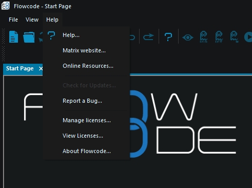

And the Help/Check for Updates/ remains not available as below:

The Help\Check for Updates... item is still grayed out not available

Re: License registration incorrect or not working
Hi Ras,
You must start a new project or load an existing project before you can update.
There must be 8 menus including help, before you can update:
(18.92 KiB) Downloaded 1325 times

Thank you Martin! :D
I opened an existing project and, as you said, the magic happened and the Help\Check for Updates... menu item was available and prompted for refreshing some FC components. I kind of understand the purpose of this if it is meant to refresh projects. May be Matrix can think of a better name for it such as project components update? Or may be a quick message is displayed on clicking on this item when it is grayed out. Honestly I was thinking that this is what I need to click for FC8 software updates for upgrading from FC8.0 to 8.1 for example in which case the menu item should be always available should it not?
