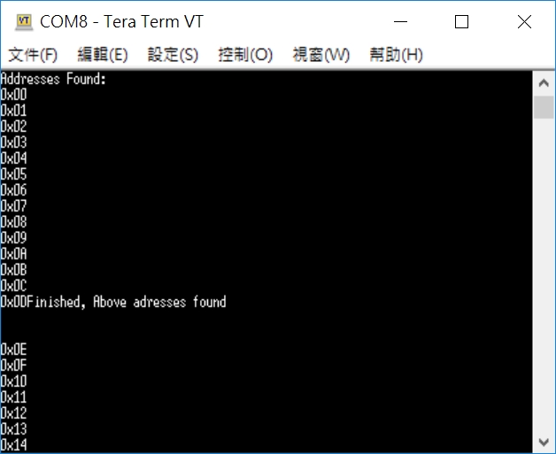

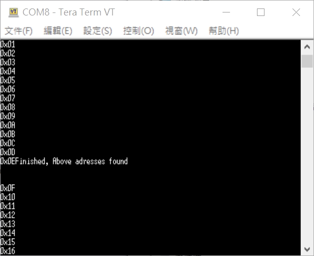

I am sorry that I replied so late.I have used the IC2 Address Sniffer ECIO40 USB.fcfx to find the I2C LCD Address.
But I always get different address by the same hardware.
Of course, my LCD still can't display, my God, it's really difficult.
Thank you very much for the help of the matrix company, I am very grateful.

I don't know why all the other addresses appear?
Assuming you have a LCD as only connected I2C device?
As a guess, can you try E0?
I will try mine again to confirm its working ok.

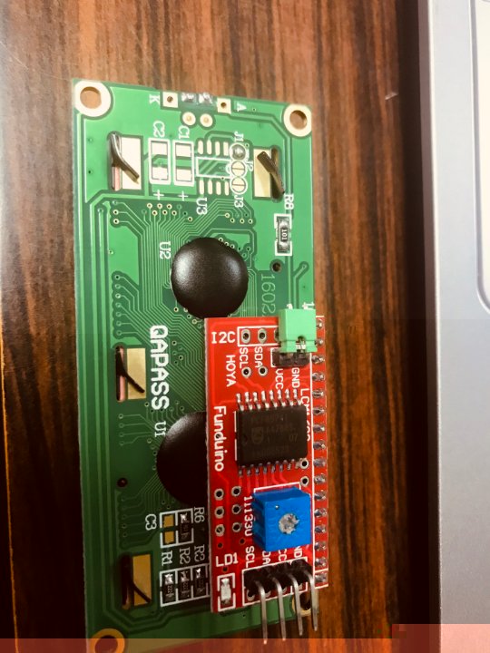

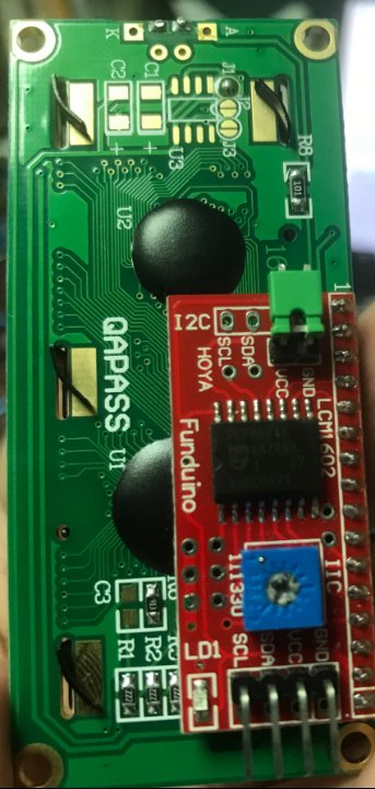

I put my I2C here.
As the relevant address did not appear, If 0x4E does not work,
I would look more closely at your hardware and connections to ECIO40P

Found your datasheet here
So 0x27 is correct without bit shift.
So what Ben suggested as 0x4E is what I would use as well.
To try 0x4E just enter 0x4E in the Address Field of the LED properties.
