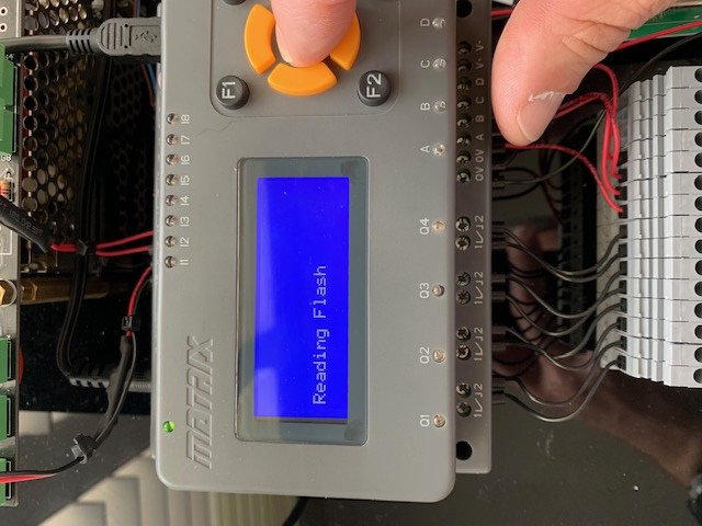

Hi Leigh,
It just says: Reading Flash when I press the OK Button (I assume it is sitting in the loop)
Regards,
Gavin

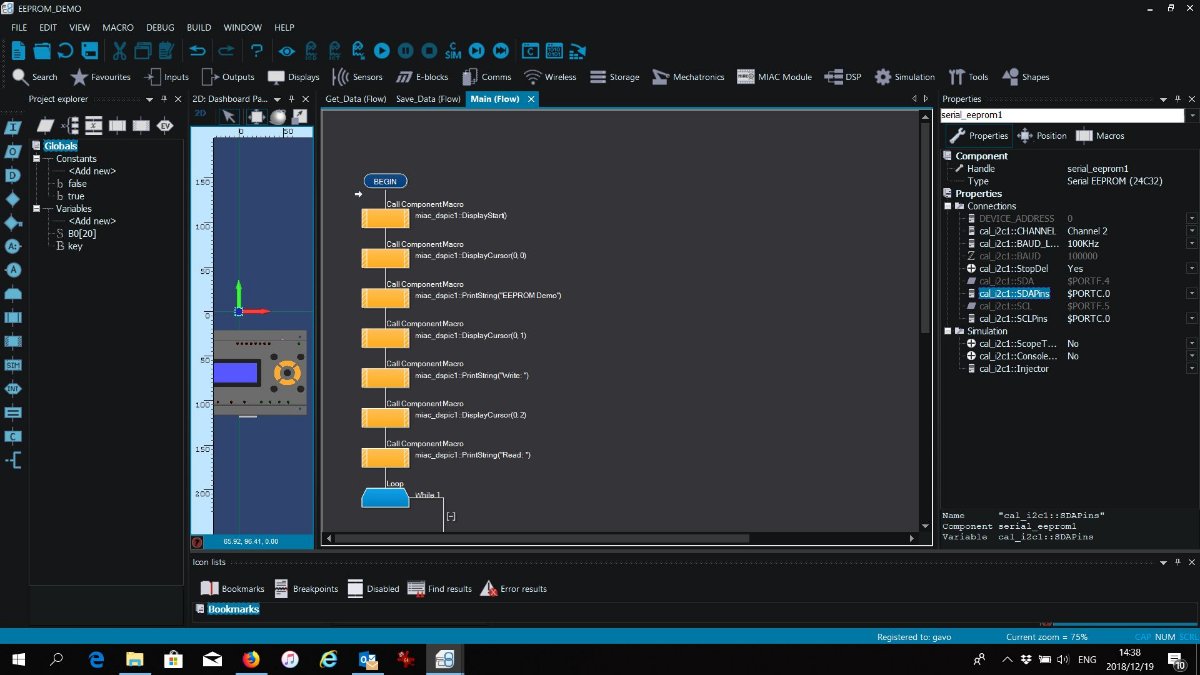

I've done a demo of the EEPROM read and write, attached. You could re-use the macros.
Press F1 or F2 to write a string, press OK to read that stored string.
Regarding your program, there is some confusion between global variables and local variables and parameters of the macros.
And some have the same names.
Inside a macro when you use any local variables, or parameters of the macro, these need to start with a dot.
So if you pass the StartAddress then inside the macro you access that with .StartAddress
Otherwise if you use StartAddress without the dot, you are actually reading the global variable StartAddress.
This is why it is better to use different names, then you don't get the wrong one in error.
The EEPROM device of the dsPIC uses Channel 2 (not Channel 1),
looks like a bug might have crept into our code there, as I thought this was automatically set,
something for me to look into.
Hope that all helps
Leigh

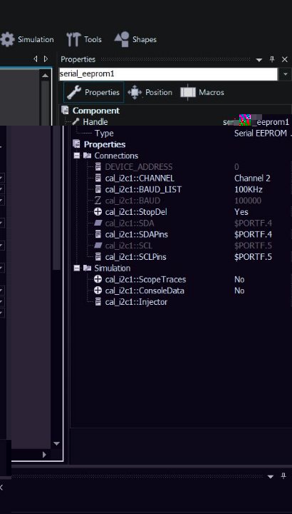

This is what I have..

Hi Leigh,
I noticed my SDA and SCL Pins are different to yours?, perhaps that is why I am seeing no saved data?
Regards,
Gavin
LeighM
Posts: 2178
Has thanked: 481 times
Been thanked: 699 times
Re: EEPROM/FLASH dspMIAC
Post by LeighM »
Hi Gavin,
Yup, it sure won't help :?
Should be Channel 2, SDA port F.4, SCL port F.5
Leigh

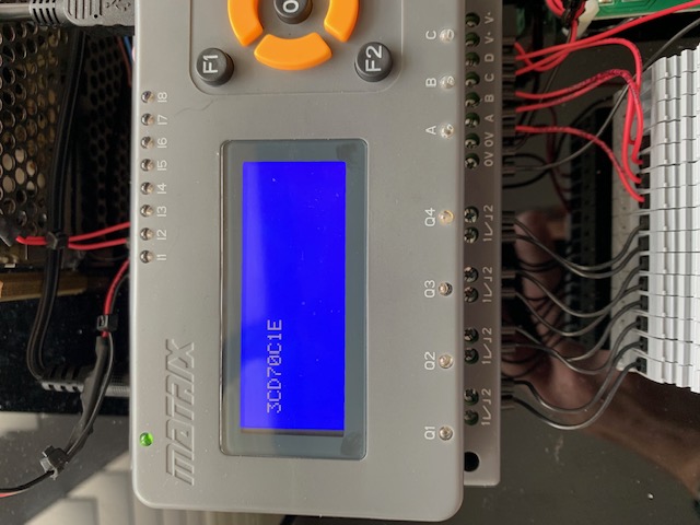

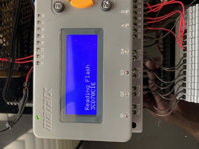

Hi Leigh,
I did try that and it did not work

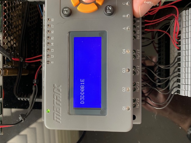

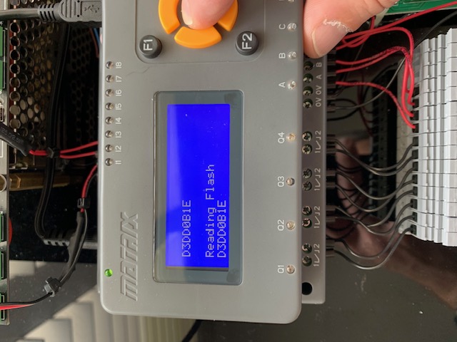

I have attached a series of Pic's from the MIAC, reading Mifare Card one I get to see the serial# and also confirm the "Save data" serial number that is has "saved the data" and also when I hold the "OK" button in after the UART Read I can see the saved data as well on the last line of the display. I am also able to read back the serial # on its own by pressing the "OK" button at any time. Works 100% - no issues

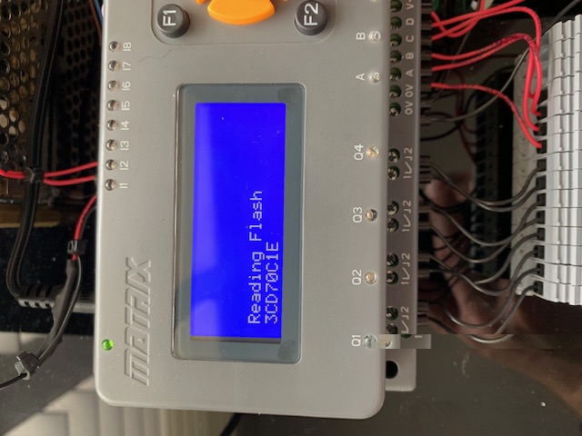

On Card 2 the number "3" is the second digit, I read the whole string back perfectly and also confirm B0 as the saved data on the second line of the display. When I keep holding in the "OK" button I can also see the value after the UART read, however when I try and read the saved serial number back on its own I can't seem to display any read data, I can only read the data back when the first digit is a "3",

LeighM
Posts: 2178
Post by LeighM »
I think the strings are getting crossed data.
You might need to have more than one buffer/string (i.e. don't use B0 for everything, such as UART receive and EEPROM read)
In particular:
1) If you are going to display the EEPROM read within Get_Data,
you don't need to place the return value into B0 (when you call Get_Data in Main)
as that is then going to be used as the input to your "If BO[x] = '3'" tests (and cause a re-write into EEPROM)
2) After your call to UART1::ReceiveString() you first need to check if BO[0] = 0
If it does, then a new string has not been received.
Only if it is non-zero do you then need go into testing for the existence of '3' in any of the locations.
Hope that helps
Leigh
