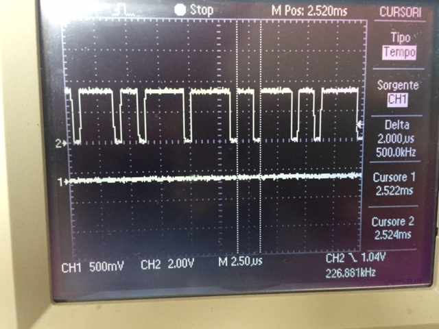

I'm comparing the 8-bit interface mode to the spi-hardware.
The speed in loading the same image using the drawer bmp is greater while keeping the same clocks.
Analyzing the speed of the WR pin, it is going to maximum at 500KHz, about 2 uS between a write and the other one, as you can see in the attached figure.
This was achieved with the 80MHz clock speed.

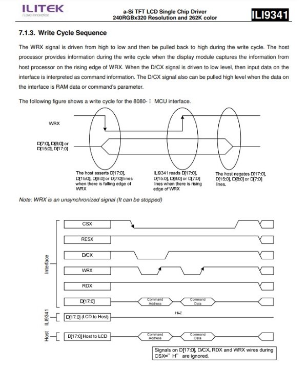

Reading the datasheet the ili9341 chip is able to receive two consecutive writes in a minimum interval of 66nS (about 30 times faster)
Is it possible, even making it settable to increase compatibility, change the writing speed?
This would help us a lot in refreshing images and / or complex screenshots.

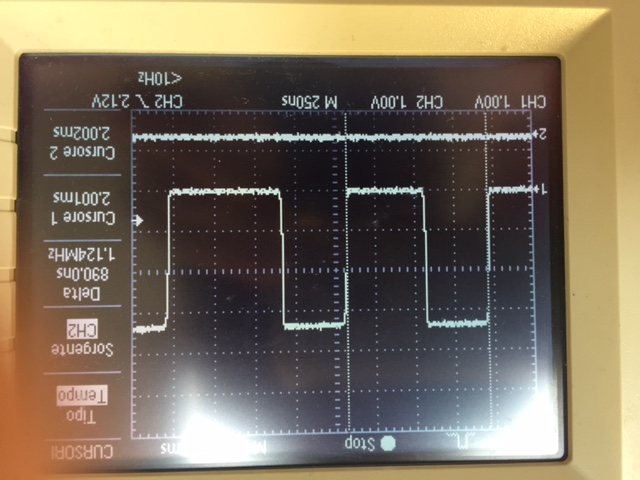

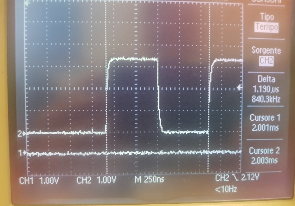

the parallel mode is influenced by the speed at which the ports go from one state to another, which affects the performance of the display.
Maybe I'm getting a bit confused with the clock settings but it seems like the pic32 is not working properly.
I made a single program that set first high and then lower the portB14 to see how fast it is in doing this operation
the cycle employs 1.2uS which is a very high time.
To make an instruction, pic use 4 clock cycles, but this value does not return with the result.

In the first image with the active instruction (8MHZ)
In the second image with the commented instruction (1.12MHz)
In the zip file the program for MPLAB
I tried to run the same port program directly from MPLAB X IDE.
In a first test the port speed was similar to that of flowcode.
Investigating a bit about microchip forums it is advisable to include the SYSTEMConfigurePerformance instruction in your program to optimize the performance of the pic.
Recompiling again I received an increase of the speed up to 8MHz it completes the entire cycle in just 125ns. (it is not yet the correct value but I am on track)
Is it possible to integrate this thing into flowocde?
- 2.JPG (80.53 KiB) Viewed 10748 times
- 1.JPG (101.38 KiB) Viewed 10748 times
- test_port.zip
- (91.81 KiB) Downloaded 208 times
