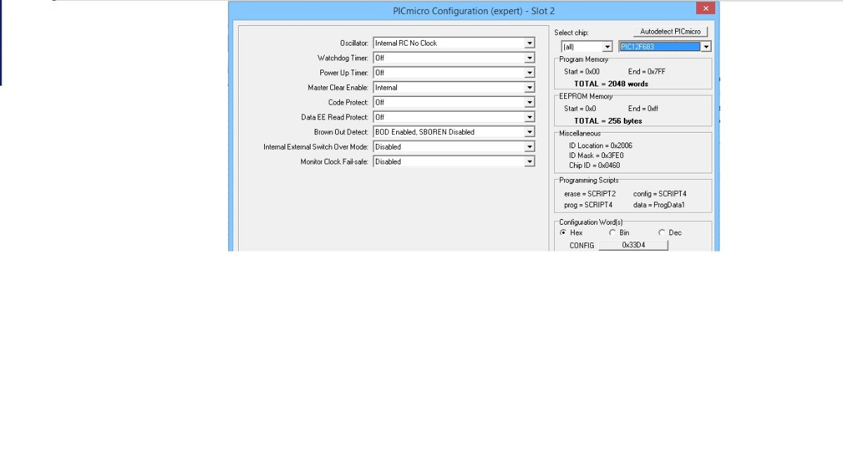

Hi Martin, not sure where I find the CODE OPTION within compiler. I have however done screen grabs of various compiler and programmer settings in the hope they will help with the issue.
Could I ask what programmer could I upgrade to for Flowcode 5. As I am still an absolute beginner I cant justify upgrading Flowcode 5 yet.I will however be getting a new laptop running Windows 10 soon. Thanks a lot.

Some more screen grabs..........
