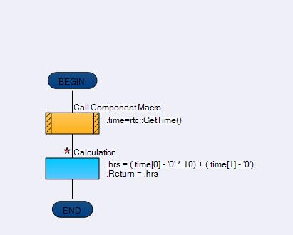

Note also that the RTC doesn't accept floating point numbers - set / get time uses a string ('HHMMSS') - if you want to convert the parts of this from a string to a number you would use something like:
- index 1 and 2 for minutes and 3, 4 for seconds.
If you need the values as a float then you can assign the value to a floating point variable (once converted to an int)

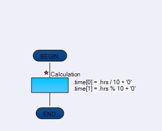

Conversion the other way
- why do you want to use a float - all the values are integer (0-23, 0-59) ?
