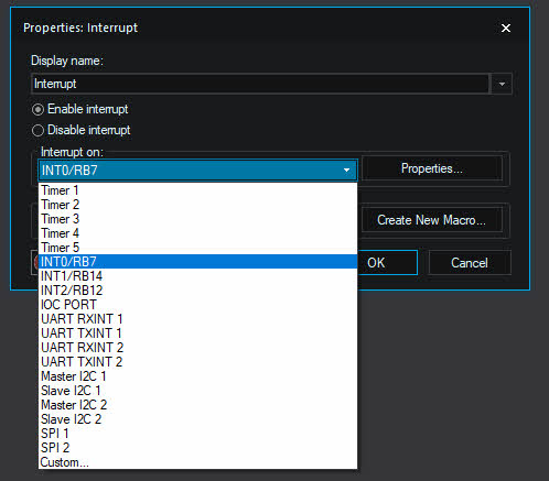

DirkB
Posts: 116
Joined: Wed Feb 08, 2012 2:45 pm
Has thanked: 7 times
Been thanked: 11 times
Re: PIC16FV32K303
Post by DirkB »
Hi Stefan (Stefan deutsch? ;o),
use the INT Icon in Flowchart, double klick on it and you will see.
Dirk

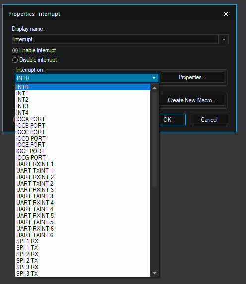

Posts: 654
Location: switzerland
Has thanked: 182 times
Been thanked: 179 times
Re: PIC16FV32K303
Hi Dirk, Hi Ben
It looks as if I need INT2 for Pin C3
(59.64 KiB) Downloaded 1980 times
Re: PIC32MZ2048EFG100 Remap INT
Hello Stefan,
If you go into the interrupt properties then it should allow you to assign the remap pin.
Do you need the interrupt to simulate? Currently the simulation pin is fixed but the downloaded pin can be remapped.
Posts: 654
Re: PIC16FV32K303
Perfect.
A little my mistake. I only looked at the INT0 and this is fixed and not remappel
In the Int2 is a nice menue for choosing the pins. I like the FC8...
(19.44 KiB) Downloaded 1976 times
