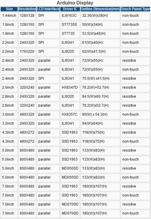

Re: 5" LCD
If you are going to use Arduino IDE:
- Arduino Displays List.jpg (109.44 KiB) Viewed 3639 times
