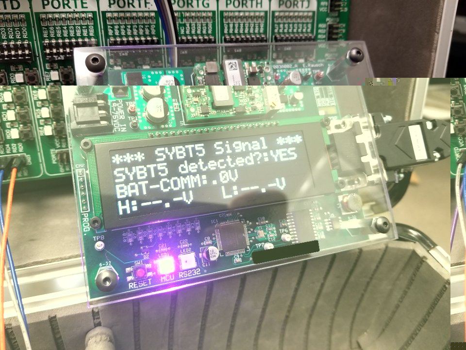

I appreciate the suggestion, buy my code is working 100% (I've attached a pic of my project)
My MCU is:
- driving an LCD display
- communicating with several I2c devices
- Driving 3 RGB LED's (WS2811)
- Converting an analog signal
As I mentioned, all baud rates above 4 kHz work 100%. I've verified this using my digital oscilloscope.
- I'm using Hardware UART Channel 1 (RC6, RC7) set to 9600 Hz (working fine. I measured it on my oscilloscope at exactly 9.6 kHz)
- I'm using Hardware UART Channel 2 (RG1, RG2) set to 2400 Hz (this one isn't working. It will only produce baud rates accurately above ~4 kHz)
