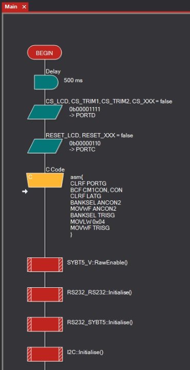

Hi there,
In previous versions of Flowcode, I used to be able to insert assembly code (asm) into my program via the 'C Code' component.
I used to do this as a workaround to the odd bug in Flowcode, or to ensure registers are set up correctly.
I would drop in the 'C Code' component, then enter my code as follows:
asm{
CLRF PORTG
BCF CM1CON, CON
CLRF LATG
BANKSEL ANCON2
MOVWF ANCON2
BANKSEL TRISG
MOVLW 0x04
MOVWF TRISG
Unfortunately, after switching to Flowcode 7, I've been really struggling with using the 'asm' command; when I compile I always get an error message - I've attached an image of a typical message.
Is there a way to get this feature to work again?
