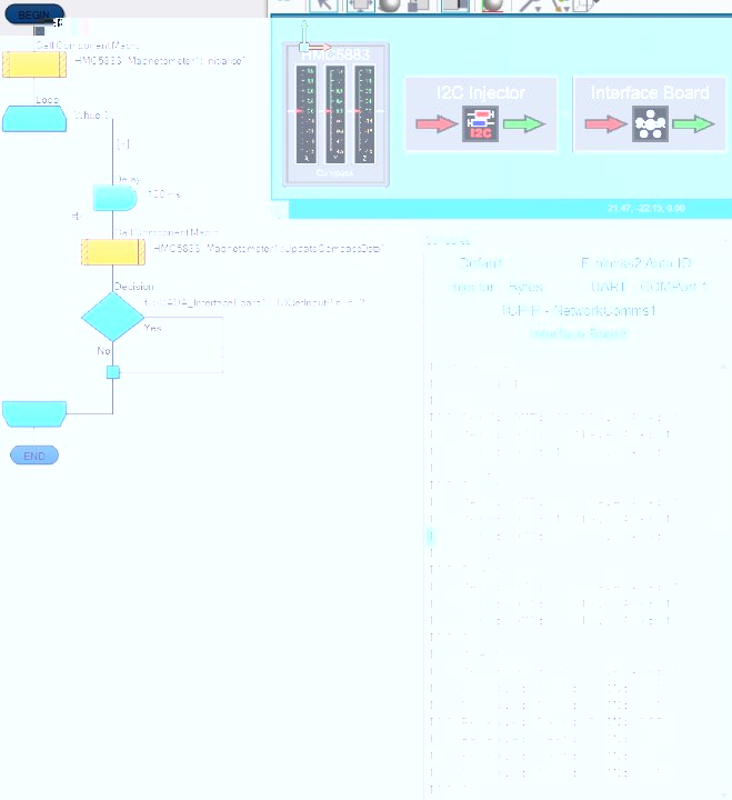

Waow, what a service. One of the many reason I love Flowcode :lol: Thank´s Ben. I have tryed to test the new component, but I didn´t managed to get it work. I am sure I am doing something wrong. Please have a look on my test.
Thank´s in advance.
Jorgen.
Compass.fcfx
(11.89 KiB) Downloaded 305 times

I change Channelmode from channel 1 to software mode, and now I see in the display for the X, Y, Z = -1, -1, -1 but no changes when I turn the compass.
Yes I have pullup resistor mounted.
These tiny module: https://www.ebay.com/itm/Magnétomètre-3 ... 2749.l2649
Any idea Ben, please.
Br Jorgen.
