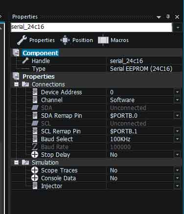

I have had a look around the forum to see why there is no hardware option problem listed for this device. I am using a PIC18F2455 with a I2C EEPROM attached to the hardware port - SCL - B1; SDA - B0.
Serial EEPROM 24C16 Properties.jpg (43.81 KiB) Viewed 6410 times
However, there is no macro available to init. the hardware port:

I have tried to include the I2C component and use its init. macro without success. The software option is working fine, just not the hardware port. No clock signal detected using handheld scope. Clock signal is present when using the software option.
Q. Is the INIT. macro missing for a reason that, at present, I am unable to deduce - or - am I missing something?

Hi Dave,
Thanks for reporting this, it does look like a bug that has crept in. I'll take a look.
For info: The component does not have or need an intialise function and it embeds an I2C component, so you don't need to add one.

Hi Dave,
Yes, it's confirmed that the component connection properties are not updating correctly.
The bug has been raised, in the meantime ...
If you change the Device Address, does the Channel then offer you Channel 1 as an option?
Once you manage to get Port B.0 and B.1 in the SDA and SCL properties, the program should compile OK.

Thank you for your very quick reply. I can confirm, the Channel properties for the component are indeed listed from the drop down menu as shown:
Channel 1 Properties A.jpg (52.42 KiB) Viewed 6382 times
However, the SCL & SDA properties are greyed out as shown:
Channel 1 Properties B.jpg (43.71 KiB) Viewed 6382 times
I have selected the port connection as shown but this makes no difference to the operation - still inactive clock signal.
