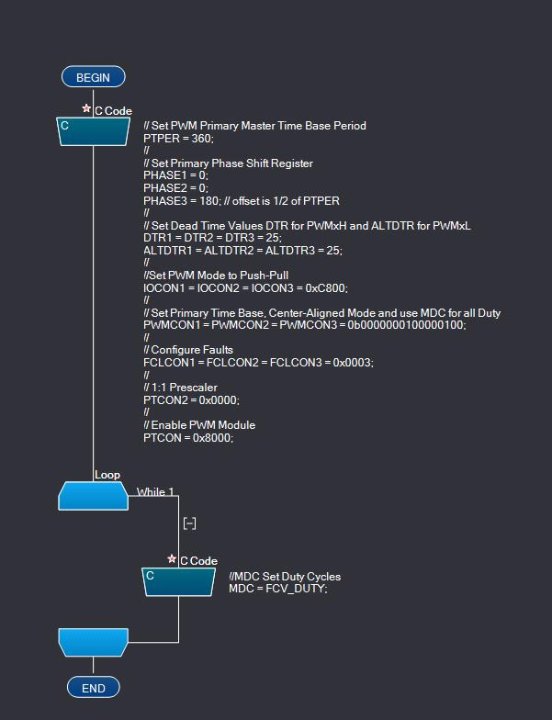

This is how I initialized and used the advanced high-speed PWM module with FlowCode8, thanks to QMESAR for pointing me in the direction, the various configurations and setup of IOCON, PWMCON, PTCON and FLTCON is available in the EV family datasheet.
- Set PWM Module dsPIC33EV.JPG (38.2 KiB) Viewed 25082 times

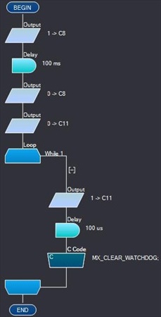

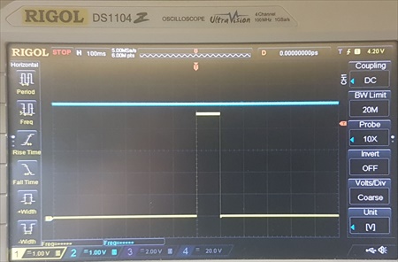

I have a problem with the dsPIC33EV256GM106 resetting, I have tried to fix this by inserting the "MX_CLEAR_WATCHDOG", switching it off in config, Auto WDT [ON] and also setting the WDT window to [None]
It happens at 5min intervals with 48MHz crystal and 12min with 20MHz crystal - this is why I think it is the WDT, but I have also checked the 5V PSU and the main OSC both clear
I attach the simple FC I use to capture the Reset on RC8, some scope traces and the project build setup page
Scope trace:
Yellow = RC8 Trip
Blue = 5V PSU (very clean at trip)
Purple = 48MHz clock (very Clean at trip)
What am I doing wrong or missing? - please help
Kind Regards
Michael

Re: support for dsPIC EV series?
Hello Ben,
I apologize for the long wait, I have been traveling / working on site.
The reset problem was caused by the "Dead Man Timer" ( _FDMT ) it is set as default Enable in FC8 -> Project Options -> Configure, if one is not looking for it specifically it is easy to miss.
Kind Regards
Michael
