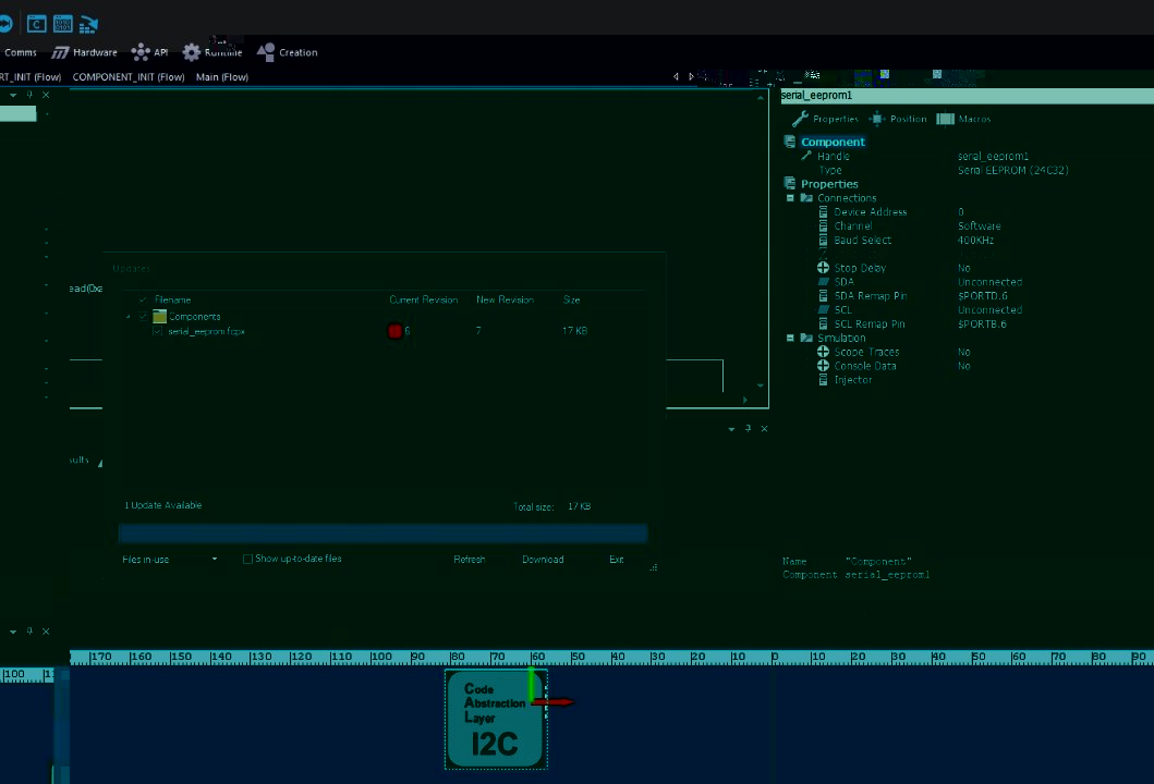

If I select the software channel it does not allow me to remap the pins at will.
Any channel I choose (soft.ch1, ch2, always shows me the same pins.
Best regards
Bug component 24c32

Hi Benj
the only way to do this is to download version 6.
With the latest version I can't select the pins.
Best Regards
Best Regards

Many thanks for letting us know.
I believe I have found and fixed the problem and pushed the updated files to the v8 update system.
Let us know how you get on.
