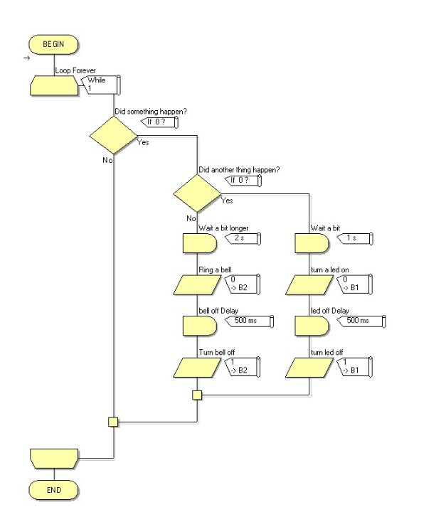

I've attached a screen grab of a simple, contrived chart to show the problem.
I know there are better ways to ring a bell and flash an LED, and I know I haven't included Input Icons to show where decision data comes from.
This is just to show the concept of the question.
You'll see that in a forever loop there's a test "did something happen?"
If it didn't, the loop repeats.
If something did happen, a 2nd decision test for "another thing" is made.
If "another thing" didn't happen, a bell rings for half a second after 2 seconds delay, then the forever loop restarts.
If "another thing" did happen, an LED lights for half a second after a 1 second delay, then the forever loop restarts.
So far so good.....
Now suppose I decide that right back at the first "did something happen?" decision, if nothing happened I'd like the bell to sound before restarting the forever loop. (Now I know it'd be easy to insert a duplicate bell-ringing routine in the "No" branch, but it's the principle of editing we're exploring here.)
Instead of the NO flow joining the square connector before loop restart, I want it to join the second vertical column just above the "Ring a bell" output icon.
Using the right-click-CUT command on the first decision diamond cuts everything to the right, all the sub-paths and actions.
Left clicking and dragging on the diamond, the "NO" path, or the summing square box, does nothing.
Hope that all makes sense; posting a link to a video is a bit beyond us....
Reverend

First of all you cant just have within your discussion branch.
It will always be false and will Yes will never be accessed.
Same as If you haveThen It will always be true and will Yes will alwayss be accessed.
what I do is within a decision branch , if I want to act on a zero value then I just use
Then in the No branch (false branch) I place all the icons I want to be executed)
My advice is change the flowchart to use a variable within decision icon, upload your flowchart and we can take it from there.
If 0
Same as If you have
If 1
If Variable_Name

Hi, thanks again for your patience!
All you say about decision boxes not working because their parameters are fixed is perfectly true. But this was not supposed to be a working chart.
I just lumped some items together to show a flow, and where I wanted to edit the (default) path of one of the decision icons.
(I mentioned that I'd not shown any Input variables - they would have set the decision parameters)
Assuming the decision icons had valid logical data, so could make a choice of "yes" or "no" paths, the flowchart would have flashed a LED or rung a bell appropriately.
I have to be AFK for a while now, but I'll try to cobble a more valid example to display my problem later.
Thanks again for you help.
The Reverend
The Reverend
