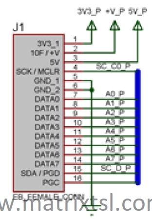

I tried to find out which pins are there on the E-Block2 programmerboard BL0080 connector. The scheme shows:
Hart-flex f connections on programmerboard BL0060.jpg (68.65 KiB) Viewed 16328 times
But, by means of resistance measurements, I found:
A0..A7 can be replced by B0..B7, etc
Harting connector on BL0080 programmer board.jpg (74.4 KiB) Viewed 16328 times
The resistance is 27R, as expected. With A6 and A7 on depending on the oscillator switch. And in case of B6 and B7, they are not directly connected to the corresponsing pins of the microchip (but only indirectly by the central chip, if the power is on).
My question is, if this numbering is correct? And can you tell what the others pins 10,12,15 and 16 are?
Kind regards
Jan
Re: Future request
Hi Jan,
In your pin numbering pin 10 is +V i.e. the voltage of the upstream MCU which is 5V or 3V3 or user selectable via a switch on the upstream board. We use this to convert incoming voltages so that they are correctly scaled to not damage the MCU.
The other pins are to do with the 10F auto ID chip on board every downstream board. Either to program the 10F device or to perform the auto ID.
