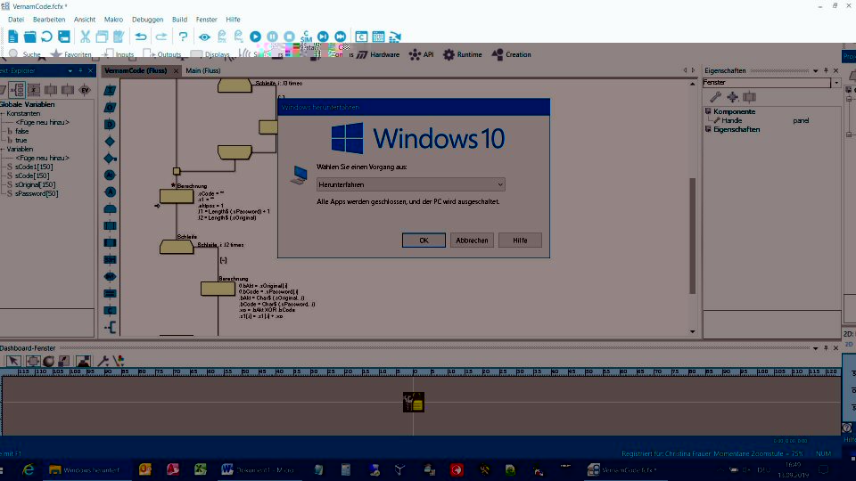

I'm using FC8 last update on Windows 10, 1903.
Since an update of MS and only in FC8, my PC says goodbye with the following error:
This occurs mainly when I create, change, or just list variables in the Project Explorer, but also
in the simulation debugger, when I delete or add variables.
With a little luck and some detours I can still save my work, otherwise everything is gone!
After restarting the PC and again with a bit of luck I need not reconfigure FC8.
Today I already deleted 2x registry entry and FC8 reconfigured, so I can continue working.
Is already a bit boring!

Just happened: during a simulation added a few variables in the simulation debugger.
Run simulation, pause, add variable (has always been a normal process) and immediately the shutdown window has appeared.
No chance to save!
