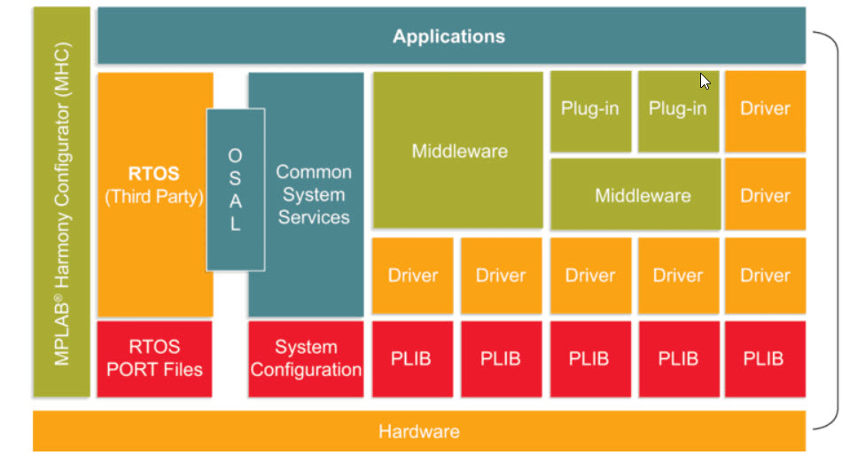

You are using a 12 Mhz Osci external. You can use MPLAB IDE with Harmomy to generate the Fowcode-Project Options- configure- parameter.
It looks like the pictures. Do you know that the PIC has a built-in 24 Mhz osci that you can use?
(120.09 KiB) Downloaded 2793 times
