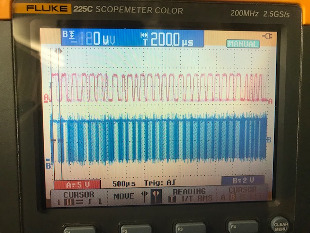

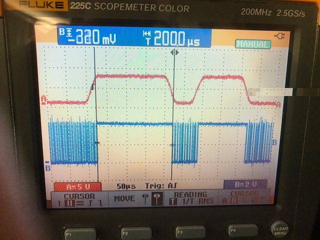

fully appreciate all the help and idea's!. I don't see all the deeper things you did yet but I imagine its hard to re-write something without being able to test or knowing what it does. but im deciphering the steps!
I had my test stuff back and simplified the code back to the first decision . I could not see why it would not pass but I found it. I made a simple test prog 1uS on 1uSec off block signal and measured it with the scope. it turned out the duration is 1,26 uS for the on and for the off so there is an oscillator way off
I lowered the SOF number for the decision and all later decisions and it passed and runs tru the code.. but still then it does not 'decode' accurate at all .. im trying to think out a way to make a visible '1' and '0' separate on my scope to see if the long and short 0's and 1' are detected.
the picture I show have a pin switched on in all the loops and off there after. this shows it switches fine...
I know its possible to get a accurate data stream because the C code I posted above I have in an simple pic controller I did buy ready and tru a terminal program on the pc by an rs232 I see all the signals... maybe I still need to find someone to get that c code to work too.

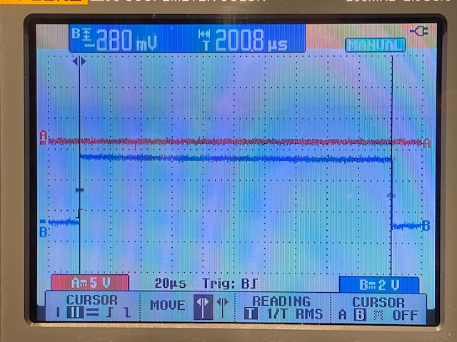

That works Martin. pretty close to the 200 now.
I looked for the supplementary code to see how I could to change it to a shorter time for the loop I had but I saw you prepared a few definitions with timings. not sure how you want to approach this. can we measure time length of a pulse in stead of counting loops?

Output looks reasonable on the oscilloscope - but receive not happy.
I'll post when it works!
Oops - defined tcnt1_buf as a byte rather than 16 bit. Now receives something reliably (ie the same every time) just not the same as the message sent
