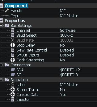

Hi Chad,
In my setup, I2C works perfect in Software mode on PIC32MZ1024EFE100.
Make sure you use the PIC32 calculator to get all timings correctly configured, otherwise it will give you trouble. I have no extra C code in the program, just adjusted the settings in Flowcode as the calculator pointed me out and worked like a charm.
https://microchipdeveloper.com/32bit:mz-osc
For my setup, the external XO is 12MHz and the MCU ends up being clocked at 198Mhz, not 200Mhz as I had before checking this PIC32 calculator, so nothing was working well including I2C, after I corrected all settings, everything worked like a charm.
Regards,
R
- FC_I2C_Master_Properties.jpg (24.18 KiB) Viewed 3250 times

I've pushed a new version of the I2C CAL for the PIC32 to the update system now. It will hopefully fix the problem and not make it twice as bad
Let me know how you get on.
