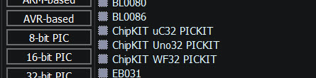

I have a chipkit UNO32. Bootloader as shown in the appendix.
