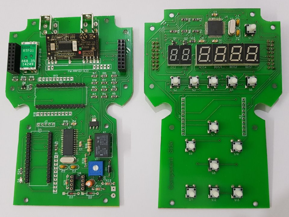

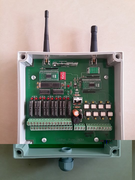

Hello! Jay Dee
My first intention was to operate two relays as any other RF module but did not work.
May I request you to help me with this module or how to operate it using RS232 and FC.
Thank you in advance.
Abhi
Abhi

Re: RPI and long distance radio
Hi Abhijit,
For long range I used the Lambda module which is LoRa based. I have used the Gamma but only achieved around 100m in our wooded environment (no where near the claimed max distance ), you would get much more in wide open space I expect.
Check the version you have as some are 3.3V and some 5v.
ensure all ground pins are connected.
Use the correct antenna type, as supplied by rf solutions if unsure.
if using for a simple relay control, no connections required for cts, rts, tx,rx pins.
using the Opt pins, set one device as a receiver (only), one as transmitter (only).
using the learn pin, ensure you have the devices 'paired' . if not they will not talk.
even if you don't have a output connected on the receiver, you should see the status light blink if it recieves data.
do a trial transmission from transmitter to reciever, can you get a receive status blink, after a transmission blink from the transmitter?... if not, re-do the learn process.
Note input/output pins are pulled internally high.
Pull to ground to activate an input pin.
Output to a resistor to +Supply, via resistor.
Note: output can only sink 12.5mA so for anything beyond an LED you will need a mosfet or driver chip to activate the relay coil.
all surface mount but I've used infineon TLE6225G & Texas Instruments ULN2003 as relay drivers....but again check the supply voltage and demands of the control pins against what the gamma output pins can supply.
Hi Abhi
Very professional looking modules you have there. I'll be very jealous if you made it all by hand
I've been in Pune a few times but not for many years now (visiting a NOC) and always enjoy my trips to India. Chicken 65 from Cochin is possibly my all time favourite food (well, perhaps pineapple curry in Borneo maybe just tops it).
I'm on route back now and over the weekend I'll document the settings that seem to work well for me and post. My antenna / enclosures are very similar to yours (but without the cool boards inside).

what a pleasant surprise, in which part of the city did you visit, let me guess, Koregaon Park/Kalyani nagar, is it? I welcome you back to Pune to enjoy your favorite foodI've been in Pune a few times but not for many years now (visiting a NOC) and always enjoy my trips to India. Chicken 65 from Cochin is possibly my all time favourite food (well, perhaps pineapple curry in Borneo maybe just tops it).
I am deeply touched for all the efforts you took for making the GAMMA topic so easy to understand for me, I am sure I will be able to work with success this time, once I am done with the present assignment (probably by the end of the coming week) I shall take all the stuff out of the box and give a try I am sure to see some results from this module (GAMMA) now.
Thank you for the compliment, yes indeed the designing work of the PCB is done by me, the remote PCB is soldered by hand but the receiver PCB (9 quantity) was soldered on wave solder machine.Very professional looking modules you have there. I'll be very jealous if you made it all by hand
Once again many thanks for all the efforts and your valuable time, I shall keep you posted, have a nice weekend.
Abhi
