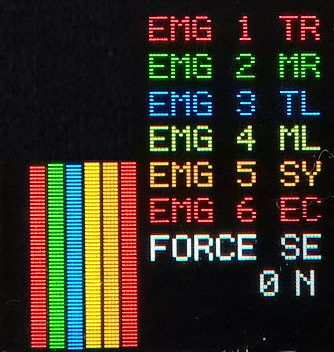

To show an audiosignal on a meter it's better to use it in special way. In the profesional studios (and in many home studios)
the cal this PPM or VU meter.
What about to include it in DSP level?
Like as
input 16Bit sint or 24(32)Bit sint
output 1 Byte (for the segment)
With this Byte output it easy to show it as graf in a small or big Display or with SCADA on the computer.
In the picture you can see a Bargraph with a 200 Segment display and the same part in a studio.
For details I can help

For my 6 channel PPM Meter I used 6 DSP System's for filtering the signal.
and show it with a small program on an Oled Display. It's working fine with the PIC32MZ
I used the same display to show ECG (signal of a heart) in an older project
http://wwww.matrixmultimedia.com/mmforu ... hilit=oled
What I have to change is the way I programed the RMS value of sine wave.
For this I like to use DSP Level component with an upgrade.
In the DSP System's I used 2 of 6 Buffer. Buffer A for input, Buffer B for output . Can I use buffer B as input for the next DSP (Level) component?
Like to use DSP components in serie. If it's not possible, it's easy to copy Buffer B to Buffer C.

With a second filter on the same DSP System is working fine. It's need a second filterTick. Thats all....
For a logarithmic scale, I used this code:
And a little wish more.... Somewhere to add a properties for a logarithmic/linear scale in the DSP Level Component.
// logarithmic scale
float1 = int2float (max_value_mittel_ch[.ch_display])
float2 = 20 * log10 (float1)
y_valuelimit = float2int (float2)
