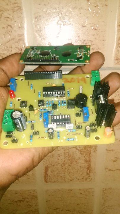

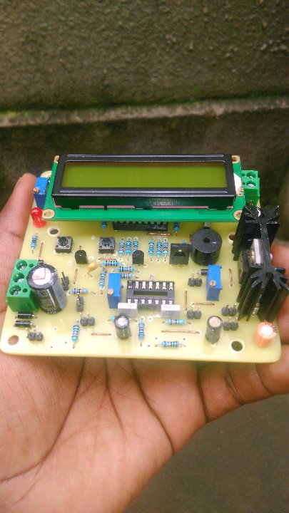

I forgot to mention that this project was a success too i will post the pictures and video for it as soon as am done with its packaging infact i believe it will be used in our hospitals here,But first i need to order its plastic case from china ,the Ear sensor and Finger tip sensor together with an LCD bezel.
Derrihj
Posts: 348
Joined: Mon Jul 09, 2018 12:43 pm
Has thanked: 67 times
Been thanked: 33 times
Re: Heart beat Pulse measurement.
Post by Derrihj »
At first i had made this PCB with the PIC16f628A but it was limiting me due to space couldn't add my custom characters and some of the code that i wanted to add so i remade the PCB with a bigger MCU and of course this time with an external crystal oscillator thanks to Martin coz at first i had used an internal oscillator which is not good enough for timing projects and since this project needs accurate timing tho for only 15 seconds, the external oscillator was a valuable Bet.I used two buttons to enter data (Age of patient) as i got that look up table from some website and also some tips from Mayo Clinic website so those two buttons are multi function buttons to input Months,Years of patient,Clear and Enter functions.I remade this project with a PIC16F886 for all my code to fit in there and my custom characters to make the all project look professional.Promised to post the finished project as soon as i raise money and buy the required but also what is going on in China warries me, sorry to our brothers and sisters there we Pray to the Almighty GOD to protect the people there and to stop the virus from spreading coz thats were i buy my staf at a cheaper price that i can afford.The circuit has many test pin-out point reason is that i was building this for the first time so i need to know values and behavior of the circuit at different points but the final product will not have all those test pins.I took the pics below as i was building the circuit with my phone a day before my phone was stolen by some bad guys at night back home in a public taxi.
