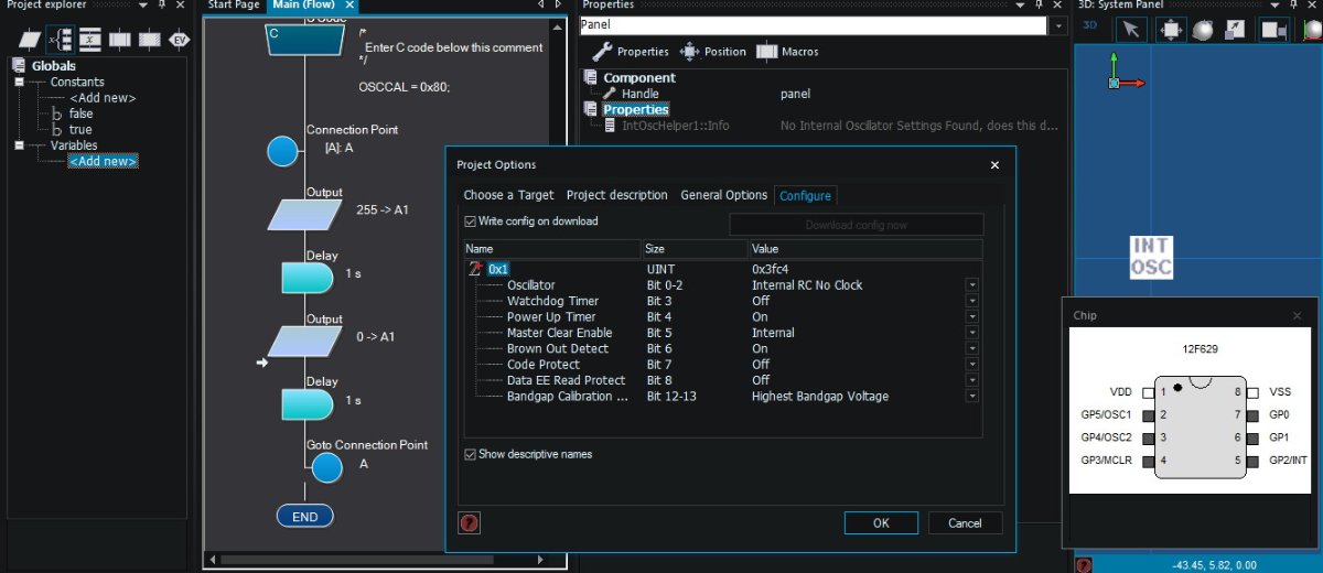

This is the simple program configuration, see image...
- flowcode 1.jpg (81.71 KiB) Viewed 25889 times

Re: Problems with PIC12F629 that doesn't program them to work
Hi bruno504,
We can't see everything within one image.
Can you post your flowchart please.
Also, could it be a programming issue?
do you have confirmation of chip being programmed and verified OK?

A few years ago (circa 2016) I created a program for a 12F675 using FC6 without issue. Nothing terribly exciting and timing was not critical. Basically it slept until an interrupt woke it, then processed before returning to sleep. Did all it needed to without issue.
Some months back I revisited the code using FC8 for a new project that would be quite similar. After updating what little "C" blocks there were I couldn't get it to run at all. I then completely wrote the code again from scratch using FC8 but still couldn't get it to work. To say it was frustrating is an understatement.
Having very little time to explore further I returned to FC6, made whatever changes necessary and it worked.
So it seems I'm not alone and wasn't going insane...medelec35 wrote:Ok the issues is with Flowcode V8 or XC8.
I'm surprised as its an old chip and only getting the port to change output.
It may have to be matrix staff that sorts this out.
I'm looking into it to see if I can get V8 to work.
Can't promise anything at this stage.
