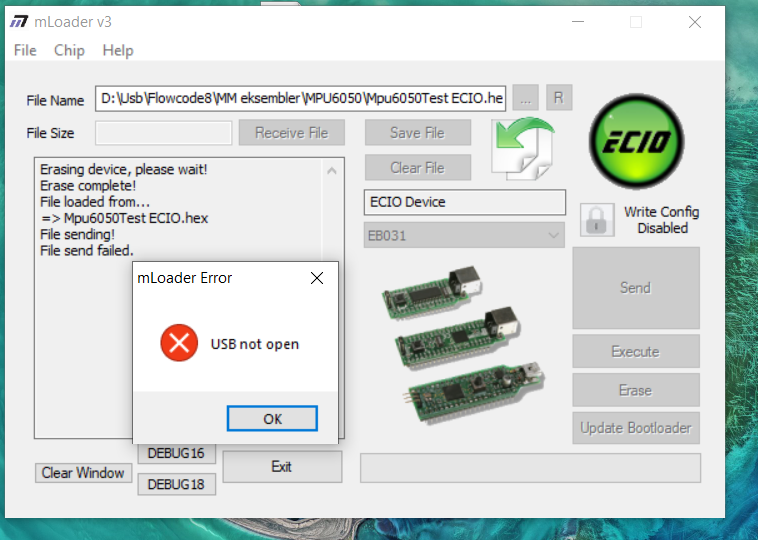

Ready for testing your program. But suddently I am not able to program the Eico?
First I try directly from Fc8, you know compiling and press te reset.
After that I try direct from Mloader. Mloader can see the device, but when I press send it can´t see the USB? And I can´t se the USB in devicemanager.
I try to install the USB driver again for Eico, but still no luck
Br Jorgen
Br Jorgen
- EicoUsb.PNG (238.07 KiB) Viewed 13862 times
- Eico40.PNG (127.09 KiB) Viewed 13862 times

Re: MPU6050
Hi Jorgen,
Go into windows settings, then devices, find your device and uninstall it.
Unplug your device and replug it.
Let windows reinstall the drivers.
Now check if you can use your device within FC8.
I had problems programming my EB091 last night and as I was about to post into the bugs section, I did the above and my board worked again.
George
George

Hi George!
Thank you. Do you mean in devicemanager or where please?. I cant see it anywhere
Br jorgen
Br jorgen

Re: MPU6050
yes in your windows device manager.
when you connect your module to your pc, can you hear the usb connected windows sound?
have FC8 and mloader closed before you do that.
If your module connects to your pc you should be able to find it in the windows device manager and when you do, right click and uninstall device.
then unplug from pc and reconnect, let windows install the driver again.
but if your module does not connect to windows as a usb device then Ben could help (corrupted bootloader maybe?)
George
George

Thank´s George. But from the start I wrote I cannot see the USB in the devicemanager, so it´s not easy to uninstall it
Br Jorgen
Br Jorgen
