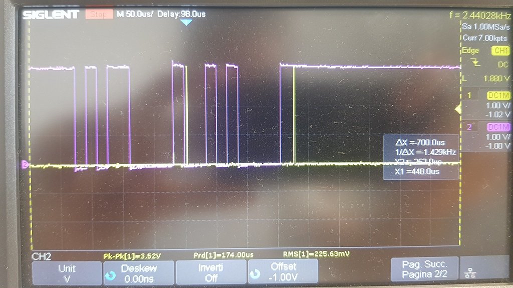

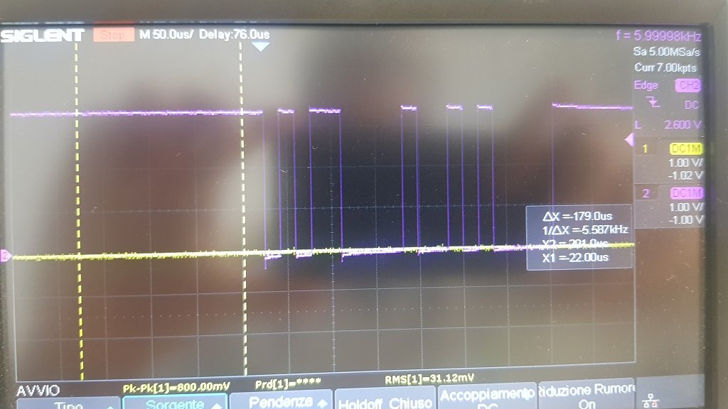

Alkaline
Posts: 143
Joined: Mon Aug 20, 2018 11:04 am
Has thanked: 42 times
Been thanked: 41 times
Re: stm32 & usart
Post by Alkaline »
Hi LeighM
ok!
edit:
In yellow is the led / pin that signals the interrupt and in pink the transmission.
There is a 179us delay from the arrival of the data to the interrupt
edit2:
I was able to replicate the problem. The module keeps sending replies but the interrupt doesn't seem to work anymore!
