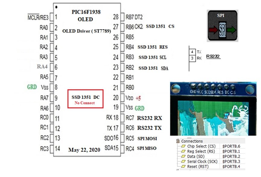

Hello All
I had a opportunity to get a could of OLED displays. I added to my exiting LCD design with removal of the LCD calls.
I went with the SPI layout because the 12C used to much memory.
I was able to work out the Flowcode 6 Design but I can't get the OLED to display anything.

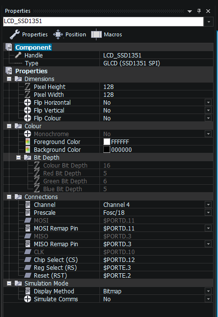

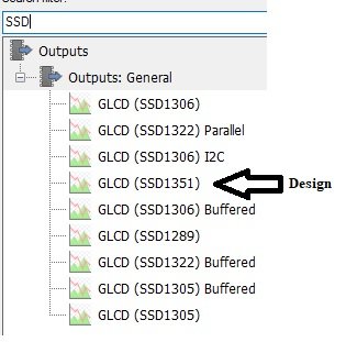

I was using the GLCD_SSD1351. I had a SSD1351 OLED but it was not working. So I tried a OLED with Driver ST7789 still nothing.
I can get the Flowcode to work just not the OLED.
Not sure if the GLCD SSD has to match to see it work on the chip.
I have attached the design JPEG and the Flowcode6 design.
Noticed that their are several SSD options and I had a SSD1351 OLED but it had a Shorted Power problem.
I searched for information on OLED design but not much luck. I did see a forum user so I could see what port to connect.
Odd it worked in Flowcode but not on the chip ?
Maybe someone has worked with OLEDs has a idea. I was trying to use 128X128 displays to get my info to display.

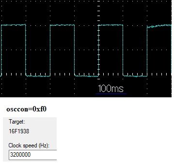

Got the 1sec timer set.
Looks like it is running at 100ms
Here is the picture
Odd this Flowcode was running with a LCD and I thought I could replace the LCD display to OLED display.
Reading up on the PIC16 it reference is 32mhz speed for inter oscillator .
Thoughts ?

The picture shows 3200000 = 3.2MHz
Should be 32000000 i.e 32 with 6 0's
Hence why delay is 10 times faster than what it should be.

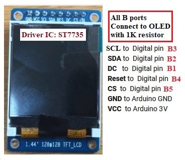

I have the Oled wired in with 1K resistors from the PIC to the OLED.
Noticed on some Google searches suggested because the PIC ports are Logic 1 at 5V.
The OLED lights up. In flowcode The OLED should display "OLED Design" When all is working the OLED design should be working like the LCD did with displaying NFR905 receiving information.
Is thing first Display something on the OLED
John
John
