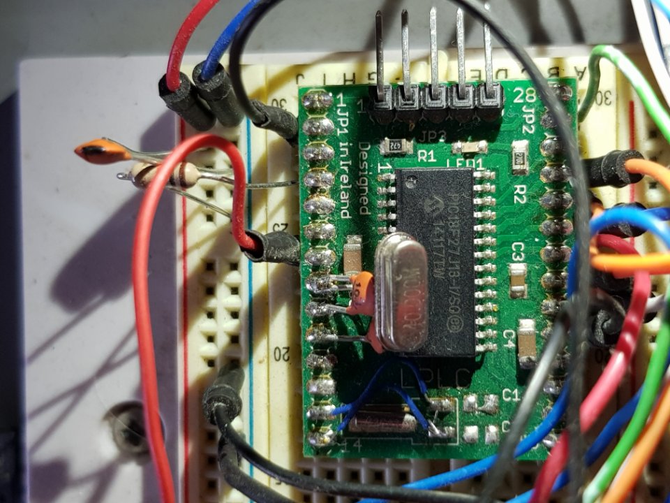

Hi Martiive not seen that page before on Matrix, a bewildering choice!
I can bypass that bit short term as I have a Pic18F27J13 already set up on a board i bought as a kickstarter project by Mike Hibbet a few years back, i have shoehorned a 40mhz xtal on it to drive an oled display so it's not slow. I can port the code across when i know exactly what i need.
Pic attached.
Ian

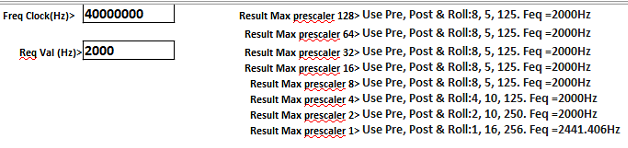

This is how I would generate a 1000Hz square wave using timer 2 interrupt.
1. Use as fast as practical clock speed, then modify configuration settings.
2. Check everything is set correctly by running 1 second flash test.
Scroll down the page for basic configuration settings.
3. Download Timer 2 Calculator from here
It's a spreadsheet, so will need excel, Libra office calc etc.
4. Enter Clock frequency and double the required frequency.
Reason for double is every time the timer interrupt is accessed the output will toggle.
output on then off = 1 complete cycle
For this example:
Clock frequency = 40MHz
Timer 2 Req Value = 2000Hz
Results: 5. Drag the timer interrupt to the start of main. It should reside outside the main look and is only accessed once.
Double click on the interrupt & Select Timer 2 from the Interrupt on:
Select Properties, Enter any of the results so long as its for 2000Hz.
We will choose Prescaler 1:4, Postscaler 1:10 & Rollover 125.
6. Select Create New Macro, Name it to something meaningful like Timer2ISR.
No Spaces are allowed.
Select OK, then OK & Edit Macro.
Drag a calculation box within Timer2ISR.
Select drop down next to <Add new> under the Global variables, select Add new.
For Initial value enter 0.
Select Bool. (results will only be 1 or 0)
Name variable to something meaningful e.g Toggle, select OK.
Click within Calculation: area, double click or drag Toggle (under Variables)
then enter =! then drag Toggle variable again.
So you should have:
Drag an output icon to below the calculation icon, double click it, change Port: and Select down arrow for the Variable or value:
Drag or double click Toggle variable.
Select Single Bit:and select the required port bit from the drop down arrow.
Select OK: Select The Main macro i.e Main(Flow) tab
Just below the timer interrupt add a Loop by dragging it.
Add a small delay within the loop, e.g 50ms: If all is set up as above, you should see a 1KHz square wave on the selected pin.
Note: the star next to icons just mean I have not save the flowchart.

Re: Piezo Sounder accuracy
Hi Martin
Thank you so much for this, it makes a great platform to start from. A couple of things, there always are (!) my output frequency was 100Hz so I changed the post scaler to 1:1 and got 1.003 KHz which is pretty bang on, I had confidence that the config was correct until I added the 1 sec pulse test and found it to be 10 secs which explains all.
I have attached the file in as there is an error in the configuration, I have gone though just about every option to find a change but there is no change for better or worse.
The other is that my Excel 2010 reported some unreadable content in the calculator and attempted to fix it which resulted in a completely blank worksheet. I have some screenshots if you would like to see them.
Many thanks
Ian
Many thanks
Ian
