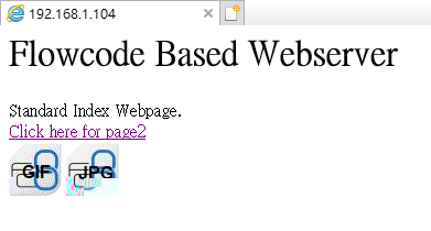

I am working on basic W5500 Webserver, all files ( index.htm and pictures ) save in SD card.

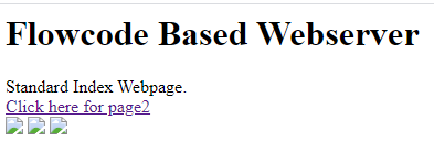

HTML Web page working great, but I got problem in showing pictures.

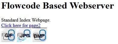

I try to run simulation with this example "WebserverFiles.zip" I found in Wiki ( also in attach), and visit 192.168.1.104 by browser. Same issue shows up. Web page can't show pictures. Or get incomplete pictures from files folder like attach below:

Please can you attach your embeded project and I'll have a look at that for you. Could be the card is not being initialised correctly?

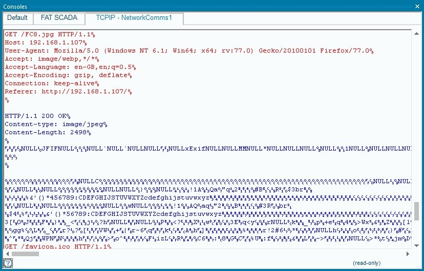

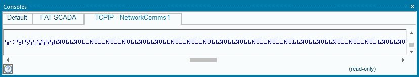

I am also getting corruption on the JPEG image which is odd as the bitmap file is working ok and that's a larger file. I'll dig in and see whats going on. Looking at the console it sends most of the JPEG data file but then towards the end it just starts sending out NULLs?
